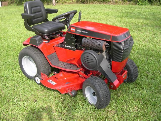

Racinbob 13,261 #53 Posted March 8, 2015 Here's another shot of it. This is before I decided to remove the arm rests and the adjuster. Also before I changed the steering wheel and decals. My butt is skinny but in any case I'm sure you'll be happy with it. 2 Share this post Link to post Share on other sites
jeff lary 173 #54 Posted March 8, 2015 (edited) that tractor looks a lot like my 312 I would show you a picture of my tractor but I don't know how? On the saw forum I just take a photo make a folder on my desktop then choose a photo fro that folder and click up-load. On this site when I click on the " Image " icon it makes a information window open and it wants a " URL" I am lost at that point I don't know what to do. Some folks use photo bucket but I don't it is just another thing to try to learn / remember how to use ya know? If there is a way for me to send a picture from a folder I have on my desk top let me know. Remember speak easy to follow language as I am a wrench sort of guy not a computer sort. Edited March 8, 2015 by jeff lary Share this post Link to post Share on other sites

Racinbob 13,261 #56 Posted March 8, 2015 Your 312 is basically the same. You may have 6" front rims but I think some had 8". You probably have a Magnum engine while mine is a Command 15. Share this post Link to post Share on other sites

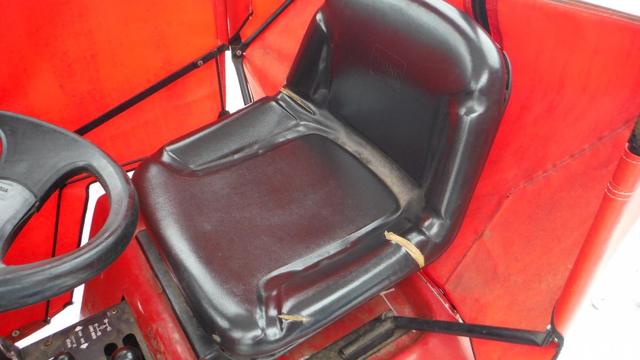

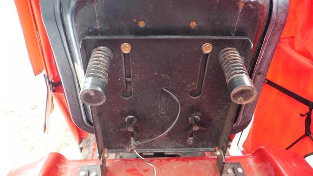

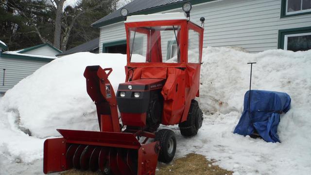

jeff lary 173 #58 Posted March 8, 2015 Here is what I am working with, the rig under the tarp is a 5000 watt generator . 1 Share this post Link to post Share on other sites
Racinbob 13,261 #59 Posted March 8, 2015 That seat pan setup is the same as mine. You'll have to drill holes but that's no biggie. You'll also have to decide what you're going to do about the seat switch. Mine was a flat switch under the padding and I could have put it on the new seat but I just left it off. I also had a goofy reverse to mow switch on the side of the pan and it didn't get put back on. Share this post Link to post Share on other sites
jeff lary 173 #60 Posted March 8, 2015 HOW DO YOU DELETE THE SEAT SWITCH ? DO YOU JUST JUMP FROM ONE OF THE WIRES OVER TO THE OTHER ONE TO MAKE A KIND OF "U " TURN IN THE WIRE? AND NO NOT HOLLERING JUST EASIER TO SEE WHEN IN CAPS Share this post Link to post Share on other sites

jeff lary 173 #64 Posted March 9, 2015 I think so ? i am not an electrical sort of guy , that stuff is all magic to me ha ha.I think the seat switch is a completed circuit when you are sitting on it. All i have to do i think is complete the circuit without sitting on the seat. I honestly dont like the idea of the seat switch not working but i dont know if there is a way to make it work with this new seat. I have ordered the seat i probably wont mess with it much till it warms up some. I am in hopes that it will go on my tractor with minimal tweeking,...i hope. Share this post Link to post Share on other sites
tunahead72 2,662 #65 Posted March 9, 2015 HOW DO YOU DELETE THE SEAT SWITCH ? DO YOU JUST JUMP FROM ONE OF THE WIRES OVER TO THE OTHER ONE TO MAKE A KIND OF "U " TURN IN THE WIRE? That's what I did on my 310-8, works fine. But please do remember how dangerous it is. If the good part of my brain doesn't stop me, I can get off my tractor with the engine running, transmission in gear and mower engaged. That could definitely bite me in the arse someday, so I have a new seat switch waiting to be installed as soon as the weather is warm. Share this post Link to post Share on other sites
jeff lary 173 #66 Posted March 9, 2015 I whole heartedly agree, I am not trying to put something over on the tractor company per se. This type of " fix " is not safe the horse is a big heavy tractor I don't need it parked on my head. Maybe I can buy a seat safety switch as well. Where did you get yours? too bad I cant just repurpose the one in the seat now. Share this post Link to post Share on other sites

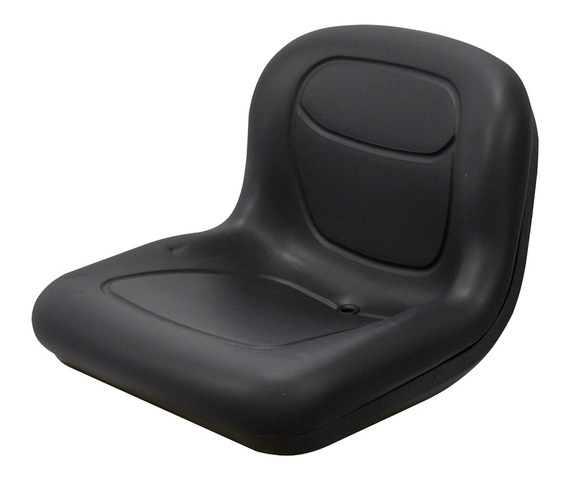

Martin 2,134 #74 Posted March 12, 2015 Bob, I used the 123. The 123 is the same as the new timecutter seat which I pictured. The seat you were sourcing from eBay looked like an older model. I found the newer style on a new zero turn at the local toro dealer and researched the oem manufacturer was KM. Www.turfseats.com is their factory outlet. Sent from my iPhone using Tapatalk Share this post Link to post Share on other sites
