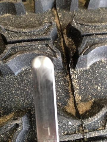

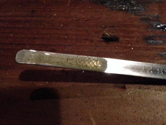

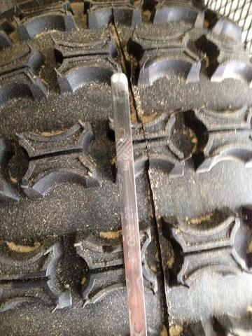

TunaSlayet 89 #27 Posted March 5, 2015 Well, I was putting in the 30wt in hole of the winter finally giving up, but I will change it out again to avoid damage to the engine. Is there a trick to getting one o these motors to heat up? I have tried running low and high rpm, and it is definitely loaded up pushing snow. I guess the next step is pulling the tins? Hopefully it just warms up soon. The real solution here is to just build a heated shed to store my tractors. The hot to cold is no good. Thanks again guys, and I will throw up some pics once the oil clears up. Share this post Link to post Share on other sites

TunaSlayet 89 #31 Posted March 5, 2015 So we got more snow, bout 6". Tried the shop towel trick, and it worked great! Ran it for about 10 minutes after most of the plowing was done, and checked the dipstick. I could actually see small amounts of steam coming from the dip stick. So again, thank you to all that have helped me through this sludgy issue. I plowed for about 45 minutes prior, and checked it. The engine was not very hot, and there was still a lot of sludge build up on the dip stick. So after all is said and done, I think It would be useful to come up with a way to restrict or regulate the airflow on the engines. Possibly somehow controlled by a thermostat. It is a trade off between reliability, and versatility I guess. Even a winter cover like you see on big rigs? Covering just enough grate area to allow the engine to heat up. Might have to look into that for next winter. Share this post Link to post Share on other sites

TunaSlayet 89 #33 Posted April 23, 2015 Just wanted to follow up to give some sort of conclusion here. After running around mowing and towing for a day, I check the oil and low and behold, it looks greatly improved! It really need to just blow off some steam I guess. Thanks to all that helped, and good luck. Share this post Link to post Share on other sites
