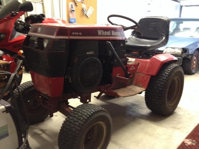

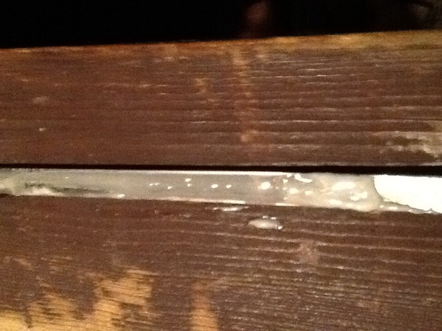

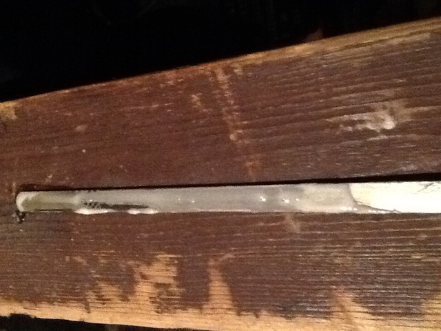

TunaSlayet 89 #1 Posted February 27, 2015 I have a recently cleaned up 414-8 with the Kohler magnum 14 hp. A little history; the tractor was pretty badly abused when I bought it. Lots of new parts, tranny flush, and a whole bunch of little thing, and it drive and runs nice now. Love the tractor, but after 3 oil changes, I keep coming up with a white sludge on the dip stick. It definitely smells like gas. So my question is, what is the source of this mystery sludge. Motor runs excellent, and doesn't smoke. Starts very easily as well. Running 5w-30. It has definitely been below 32 degrees here in mass. Any help would be greatly appreciated. Definitely do not want to damage or cause excessive wear to my engine. Share this post Link to post Share on other sites

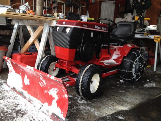

Digger 66 3,488 #2 Posted February 27, 2015 Smells like gas ? Sounds like rings to me . Is that a bike chain around your front tires ? Share this post Link to post Share on other sites
TunaSlayet 89 #3 Posted February 27, 2015 Yes sir, quality mod I found on red square somewhere. 20 bucks from tsc, little elbow grease, and your rolling. #50 roller chain. Makes steering much easier, and it bites into ice and snow real nice. Could not be happier with them. Actually considering painting them, or finding some kind of coating, because they rust up real fast. Couple passes, and they look good again, but seems to be a potential issue in the future. So rings...ahhhh. How bad is that to do? Share this post Link to post Share on other sites

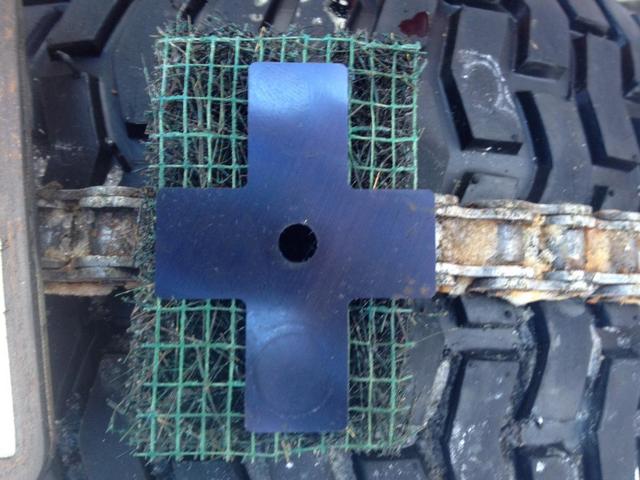

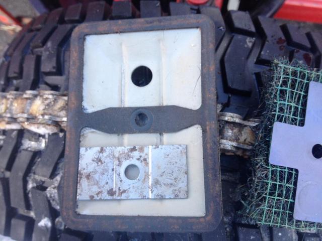

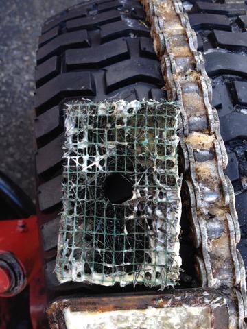

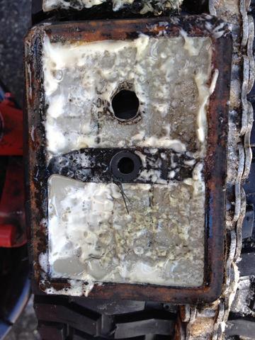

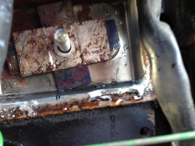

TunaSlayet 89 #18 Posted February 28, 2015 So I cleaned out the breather, and changed the oil to SAE 30. Also tried to clean as much sludge out of the dip stick tube. I am beginning to think this is mainly a moisture issue. There was a lot of condensation in the air filter, and vent assembly. Way more than I expected. Here are some before and after pictures. Kind of want to eliminate the moisture issue before I spend 100 bucks on a fuel pump. I smelled the oil in my 420, and smelled it in the 414, and it did not smell any more gassy, but I have a terrible sense of smell anyway. Does anyone know if gas creates this white sludge, or water? Or is it just a horrible combination of both..I'll tell ya, I have a lot of respect for a motor that can deal with oil like this, and not just explode immediately. Share this post Link to post Share on other sites
km3h 543 #19 Posted February 28, 2015 (edited) Milky oil is cause by water or condensation. Gas will simply dilute the oil it will not change the color. It would take a lot of condensation to cause this. Don't buy an oil pump if you don't smell gas in the oil. When the pump leaks gas into the crankcase, it really leaks a lot and the crankcase will overfill quickly. Edited February 28, 2015 by km3h Share this post Link to post Share on other sites

TunaSlayet 89 #24 Posted March 1, 2015 No heat in the garage, but it is definitely moist in there. It does get ran for short intervals usually. It take about 20 minutes to 1/2 hour to clear my driveway, and we have had a lot of these little storms. I have never opened up the breather, so it may have been full of junk before I got it, but now at least I have a base line to work off. The oil is not overfilling, so I am just going to work on the moisture issue for now. I like the idea of getting it good and hot to burn off the moisture. I will have to take it for a ride down the dunkin doughnuts drive through to stretch her legs a little.. Thanks for all the advice, and input guys! I will check around to see if I can get one of the K series breathers. Possible lindstrom wheelhorse? Definitely wanna put this one to bed. Water and my motor are not friends. Share this post Link to post Share on other sites
