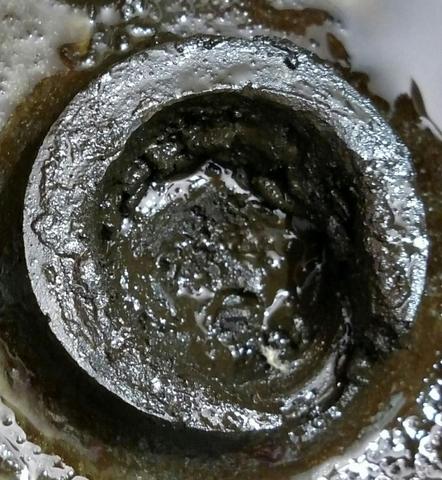

chazm 413 #2 Posted February 22, 2015 OK.... seen your other post about trans build going bad .... so whats up ? Share this post Link to post Share on other sites
King Horse 22 #3 Posted February 22, 2015 Looks like the case is worn from the bearing being destroyed Share this post Link to post Share on other sites
stevasaurus 23,420 #4 Posted February 22, 2015 Are you looking for some help here?? Nice pictures. I agree...the picture in your other post...that half of the case is toast. Share this post Link to post Share on other sites
King Horse 22 #5 Posted February 22, 2015 I guess its tranny shopping time. Share this post Link to post Share on other sites

stevasaurus 23,420 #13 Posted February 23, 2015 Yep...that is called an "11 / 44 toothed" gear or mushroom gear. You would need one from a 5025 3 speed trans...not from a 4 speed transmission. That gear, you have, is long enough to have your brake drum on it. In the 4 speed transmissions, the brake drum sits on the cluster gear shaft (which comes out a different hole) in the trans case. Share this post Link to post Share on other sites
King Horse 22 #14 Posted February 23, 2015 So that gear rides on the #4 needle bearing? Share this post Link to post Share on other sites
stevasaurus 23,420 #15 Posted February 23, 2015 It is hard to tell in your picture, but it looks like a yes. The chewed up end of that gear sits in the spot that is all chewed up. Take a picture that shows the whole inside of that case. Share this post Link to post Share on other sites
King Horse 22 #16 Posted February 23, 2015 I will try but it won't let me upload that big of picture file. I was just confused on why there was a worm gear in a needle bearing. Share this post Link to post Share on other sites

King Horse 22 #19 Posted February 24, 2015 So back to the shaft..so this is the wrong shaft for this transmission? Share this post Link to post Share on other sites
racinfool40 203 #20 Posted February 25, 2015 Spent some time on the phone with King Horse and did some swapping of pics...Think we got it all ironed out... 2 Share this post Link to post Share on other sites
