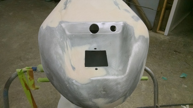

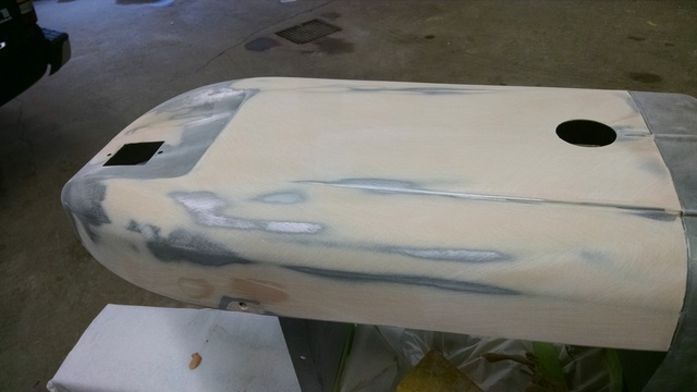

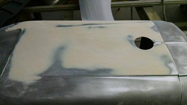

Jake Kuhn 1,600 #27 Posted February 12, 2016 Been a while for updating this 1 too, picked up new tires for it, frame and hood are ready for paint, Basically just need to finish the hood and steering wheel. Finally started the body work on the hood today. Still quite a bit of time to spend on it, but off to a good start. Thanks, Jake 5 Share this post Link to post Share on other sites

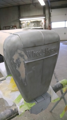

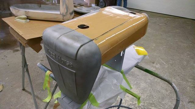

Jake Kuhn 1,600 #28 Posted February 13, 2016 Finished up and ready for a coat of primer. 6 Share this post Link to post Share on other sites
Racinbob 13,261 #29 Posted February 13, 2016 You amaze me Jake. Ya might want to keep an eye out for rust on the bare metal. Steve and I were on Skype yesterday talking about it and we may have drooled some What is that filler you're using? 4 Share this post Link to post Share on other sites
Jake Kuhn 1,600 #30 Posted February 13, 2016 Thanks Bob! I will be primed soon and humidity isn't much of a problem this time of year around here. But for filler we use evercoat rage, it is kind of expensive but really nice stuff. 2 Share this post Link to post Share on other sites
WHX?? 58,339 #31 Posted February 19, 2016 What's the hole to the right of the steering wheel hole for? Share this post Link to post Share on other sites
RedRanger 1,470 #32 Posted February 19, 2016 1 hour ago, WHX6 said: What's the hole to the right of the steering wheel hole for? Nitrous or Eject? Share this post Link to post Share on other sites
Racinbob 13,261 #33 Posted February 19, 2016 1 hour ago, WHX6 said: What's the hole to the right of the steering wheel hole for? Good question. Some don't have that hole. Mine does and I'm relocating the motor kill button from the engine to that hole. Share this post Link to post Share on other sites
Jake Kuhn 1,600 #34 Posted February 19, 2016 2 hours ago, WHX6 said: What's the hole to the right of the steering wheel hole for? Those were for the ignition switch on the 550s. On the 400 they usually just put a plug in them because the kill switch is the throttle control. I believe most if not all had it that way they could just share the same hood for the 2 tractors. 1 Share this post Link to post Share on other sites
WHX?? 58,339 #35 Posted February 19, 2016 1 hour ago, Racinbob said: Some don't have that hole. Thats why I was wondering cause mine doesn't have one either. Good place for a kill switch tho. Share this post Link to post Share on other sites
Racinbob 13,261 #36 Posted February 20, 2016 Now that there makes sense Jake. Thanks Share this post Link to post Share on other sites

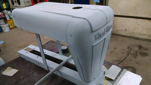

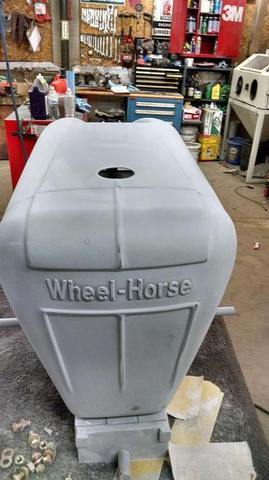

Jake Kuhn 1,600 #37 Posted March 18, 2016 Finally finished up the body work on the hood. Need to go over the frame 1 last time, and glue in a tank strap and this will be ready for paint and I can start putting it together. 6 Share this post Link to post Share on other sites
Pullstart 71,488 #38 Posted March 18, 2016 Jake, How many projects are you down- or up to now? Nice to see progress from any of them, wish I could find the time to start just one! Share this post Link to post Share on other sites
Jake Kuhn 1,600 #39 Posted March 19, 2016 Kevin, I have this, the 59 and the 56 both getting full redos and many others torn apart in various stages. I hope to finish this and the 59 in the next month or so, they are getting close. 3 Share this post Link to post Share on other sites
