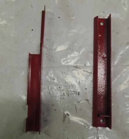

rickinmemphis 1 #1 Posted February 21, 2015 I tore my 1975 c120 down to nut and bolts. Cleaned, Primed and added some paint. I then put it back together. I ended up with some left over parts. I remember taking them off but not from where. I could sure use some help with this. Anybody have any Pict of where they came from. Memory is not what it used to be. Share this post Link to post Share on other sites

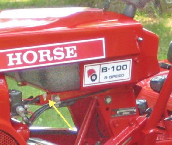

rustykan 140 #2 Posted February 21, 2015 I recognize the part on the left. It is mounted on the left side, under the gas tank. It would be where the wiring harness runs through and the fuel line is also mounted. Can't seem to find a picture to help. Not sure about the other part. Share this post Link to post Share on other sites
daveoman1966 3,882 #3 Posted February 21, 2015 (edited) You have a C-120 Auto, or is it an 8-speed? The part on left is #102810 (channel) that bolts to the TOP-LEFT side of the hoodstand, just under the gas tank support. It should enclose / tie down some wires and there is a clamp that bolts to it to tie down/brace CHOKE cable. Can't ID part on RIGHT Edited February 21, 2015 by daveoman1966 Share this post Link to post Share on other sites

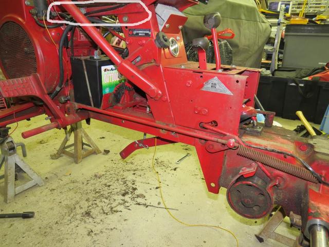

rustykan 140 #4 Posted February 21, 2015 I recognize the part on the left. It is mounted on the left side, under the gas tank. It would be where the wiring harness runs through and the fuel line is also mounted. Can't seem to find a picture to help. Not sure about the other part. This is the best I could find. The area circled in white is where it goes. Hope this helps. Share this post Link to post Share on other sites
Don1977 605 #5 Posted February 21, 2015 (edited) Might be a battery tie down, the holes look to be 1/4". They used a wire tie down like in the picture above. I change mine to a small angle iron with a couple of 1/4" holes. Item on the right. Edited February 21, 2015 by Don1977 Share this post Link to post Share on other sites
rmaynard 16,869 #6 Posted February 21, 2015 Item on left: Share this post Link to post Share on other sites
