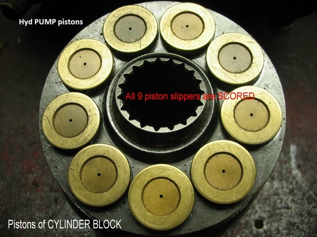

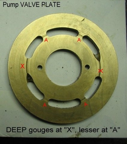

daveoman1966 3,882 #4 Posted February 21, 2015 Before you mount the Sundstrand hyd power unit (90-1172) back onto the C-121, you should inspect the internals of the PUMP and the MOTOR for wear. If the brass surfaces of the 9 slippers (18 total) are worn or scratched at all, your tractor's power will exhibit progressive power loss. There are other sensitive machine-face surfaces that need exam too...not just the pistons. Here is an example of what you are likely to find in the pump...nearly identical parts in the motor section. If yours look anything like these, consider rebuild. For more info or pics, contact me here: daveoman@windstream.net Share this post Link to post Share on other sites
greenb69 1 #5 Posted February 21, 2015 That is excellent info. And the pictures will be very useful. Thank you very much. I will let you know what I find. Share this post Link to post Share on other sites
