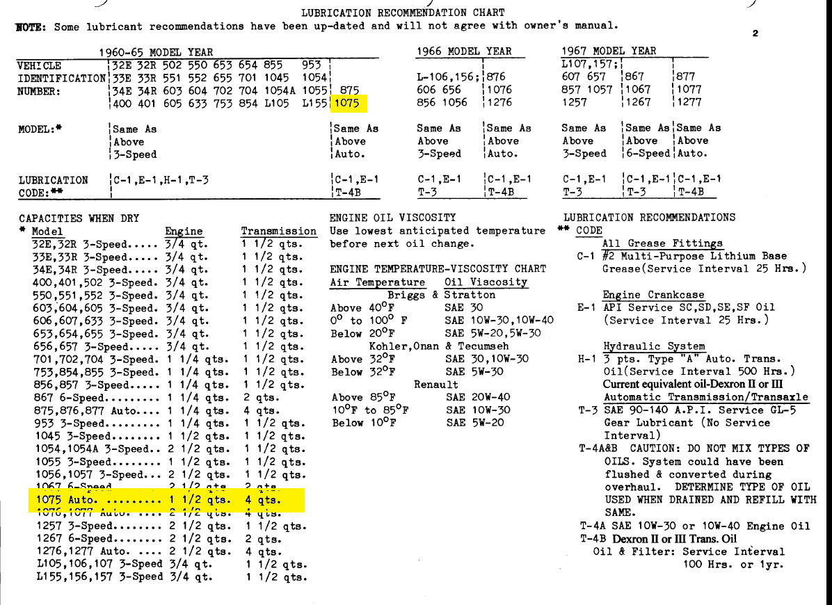

Coley909 12 #1 Posted February 15, 2015 Changing my oil during the plowing season. I looked it up on tractor data they say 2.5 qts my manual says 3 pints which is 1.5 qts so who's right? Probably the manual... Just want to make sure. Should I change the transmissions fluid as well? Share this post Link to post Share on other sites
rmaynard 16,837 #2 Posted February 15, 2015 From the Toro/Wheel Horse Lubrication Bulletin 1 Share this post Link to post Share on other sites

Coley909 12 #4 Posted February 19, 2015 Well I wanted to just top off my transmission fluid but I don't have the slightest clue what fluid is in there now. Should I switch to 10w-30? Should I use dextron 3? How do I switch fluids? Sent from my iPhone using Tapatalk Share this post Link to post Share on other sites
pfrederi 19,764 #5 Posted February 19, 2015 Wipe the dip stick on a clean paper towel. if it is red it is ATF (Dexron3). Tan or darker it is motor oil. I would stick with what ever you have in there now. They do not mix well and flushing is a project. Share this post Link to post Share on other sites
