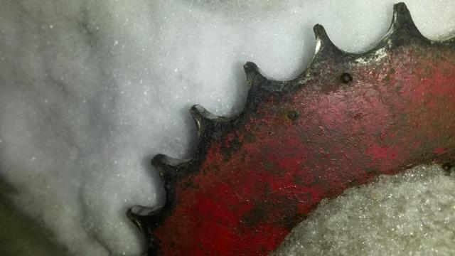

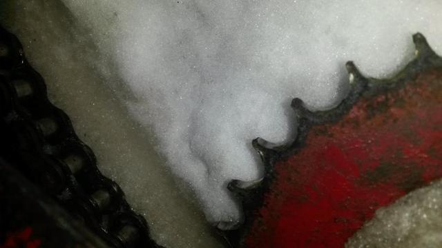

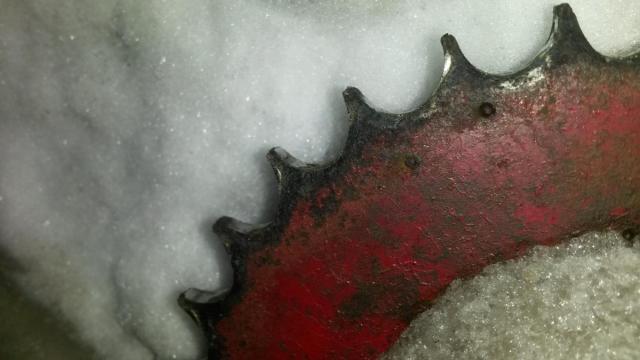

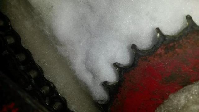

bionicfisherman 19 #1 Posted February 10, 2015 (edited) I was out blowing some snow last night a noticed chain was a little loose.... I grabbed the chain a gave it a tug and the whole auger moved. Anyone rebuild a auger before? Under further inspection I see the sprocket on the auger is very worn out tooth wise, is this something that could be cut and welded? Edited February 10, 2015 by bionicfisherman Share this post Link to post Share on other sites
baerpath 517 #2 Posted February 11, 2015 Yes sprocket can be changed Share this post Link to post Share on other sites
ericj 1,579 #3 Posted February 11, 2015 there is several threads on here about rebuild of blowers good luck eric j 1 Share this post Link to post Share on other sites
bionicfisherman 19 #4 Posted February 11, 2015 there is several threads on here about rebuild of blowers good luck eric j Yes sprocket can be changed Can you point me in the right direction? Share this post Link to post Share on other sites
MalMac 1,333 #5 Posted February 11, 2015 (edited) Do a search for 42 inch Auger, Deer Whisper had to replace one. It's a good post about just replacing the sprocket. Edited February 11, 2015 by MalMac 1 Share this post Link to post Share on other sites
Kurt-NEPA 755 #6 Posted February 11, 2015 I picked up a basket case single stage tall chute last summer. All the bearings were gone, but went I got it apart the auger shaft sprocket was worse than yours. I almost scrapped the whole unit. But I took a chance, I cut the old sprocket off the shaft and bought a new hub and sprocket from McMaster. I had to bore out the hub to fit the auger shaft. Then I positioned it and cross drilled for a bolt. Its been working like new all winter. But if I had a welder, I would have just cut off the old sprocket and welded in a new one. If I remember correctly it was a 55 tooth #40 chain sprocket. TSC had them, so does Surplus Center. You might still have to bore it out to fit the shaft. Best of luck Share this post Link to post Share on other sites
can whlvr 994 #7 Posted February 13, 2015 I have rebuilt 3 throwers,a couple more than once,if the sprocket is that worn I would suspect she is in need of all 4 bearings and both idlers too,look at the drive sprocket too,these throwers work great but do take a beating and if all parts are not in good shape something will break,i live in a snow belt and the throwers get a lot of use so im just giving my opinion,ya it costs,but in the end when shes tearing through a foot of snow its nice to be able to count on it 2 Share this post Link to post Share on other sites
bionicfisherman 19 #8 Posted February 17, 2015 I'm going to limp it through the rest of this winter and rebuild it over the summer. It will give me time to source out the parts to fix it. I've done the two shaft bearing 2 years ago but I might as well just replace everything all at once and save them as spare units. If any one has part numbers or alternate sources other then Toro for cheap parts the info would be welcomed. Share this post Link to post Share on other sites
