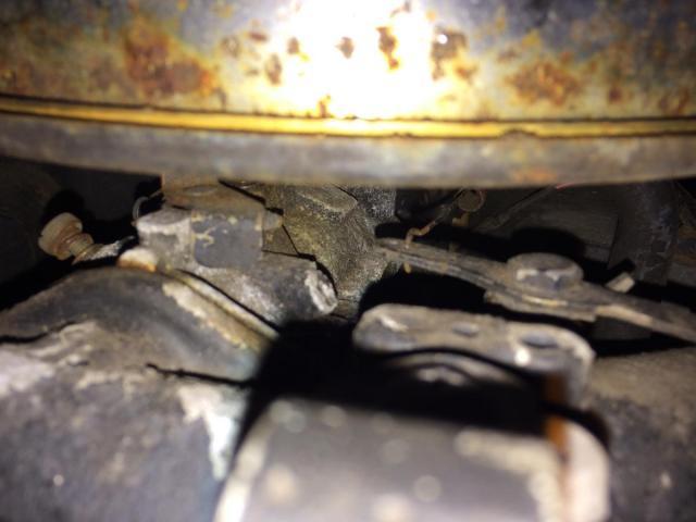

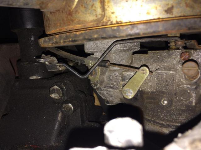

19richie66 17,789 #4 Posted February 6, 2015 Didnt have time to take the air cleaner off but I did get a couple of pictures. The rod that operates the throttle butterfly connects in the second hole on the governor lever. The spring on the other side of the carb is in the second hole on the smaller lever. Ill try to get better pics blue. Sorry i run out of daylight. Share this post Link to post Share on other sites
