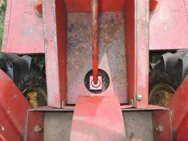

rmaynard 16,700 #16 Posted February 5, 2015 (edited) In an ideal world, some of those ideas might work, but only if the screw is loose enough to turn. But the reason it broke is because it is frozen by rust. And the area that Steve has to work with is this. The only solution in my opinion is to remove the transmission, then drill or whatever on the bench. The area is just too tight to get anything into. Edited February 5, 2015 by rmaynard 1 Share this post Link to post Share on other sites
