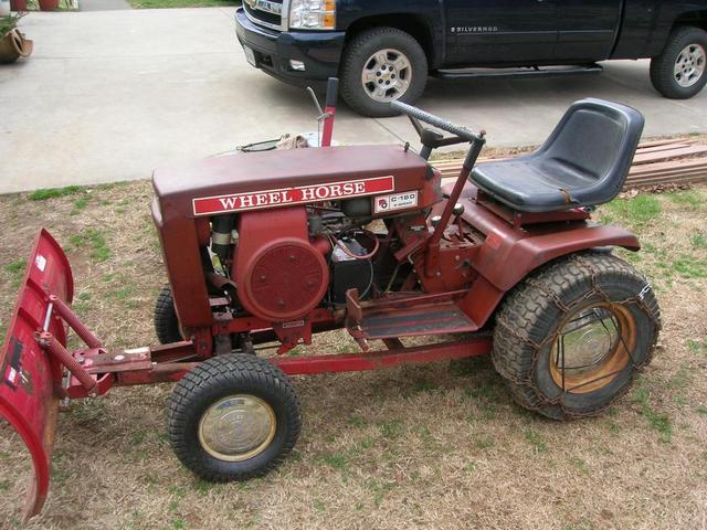

wheelhorsekid 141 #1 Posted February 4, 2015 I just got a C-160 added to the stable and love the patina it has. However, I want to slow the aging process. My questions is has anyone simply clear coated their horse? Would love to hear about it and see some pics. Share this post Link to post Share on other sites

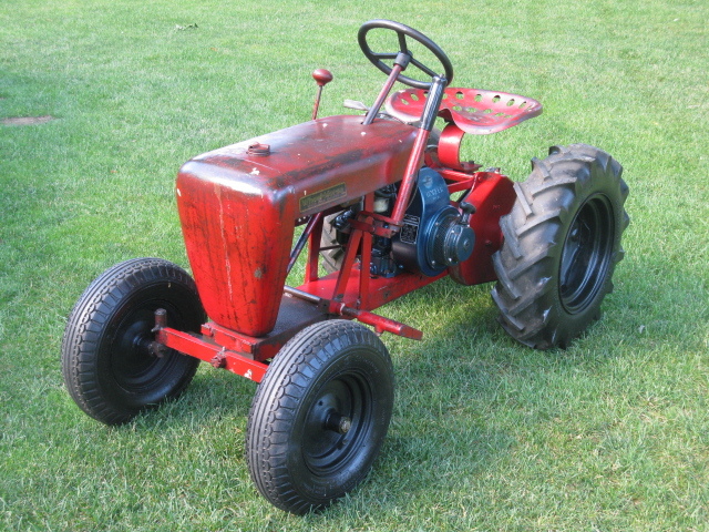

fourwheels0 191 #10 Posted February 5, 2015 (edited) I've used used motor oil before. just scrub everything down real good to get any big chunks and loose stuff off then went over every square inch.after that rub it down with a clean dry cloth. Edited February 5, 2015 by fourwheels0 Share this post Link to post Share on other sites
slammer302 2,156 #11 Posted February 5, 2015 Looks good fourwheels0 Share this post Link to post Share on other sites

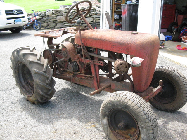

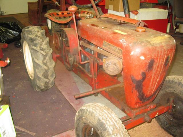

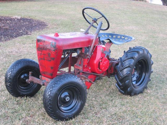

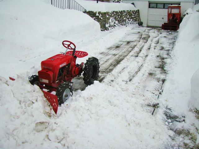

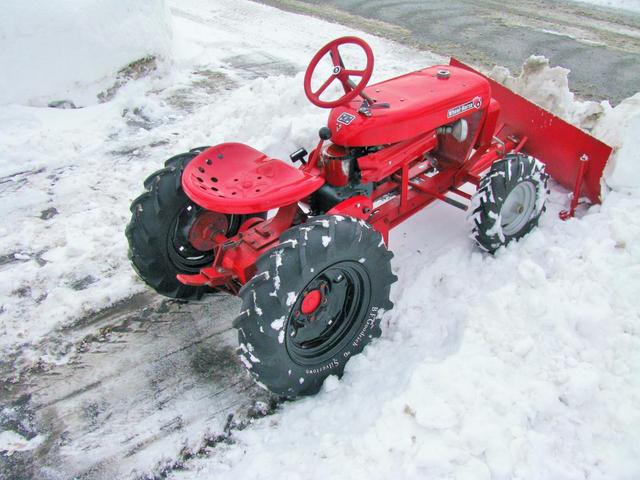

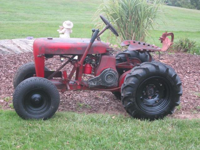

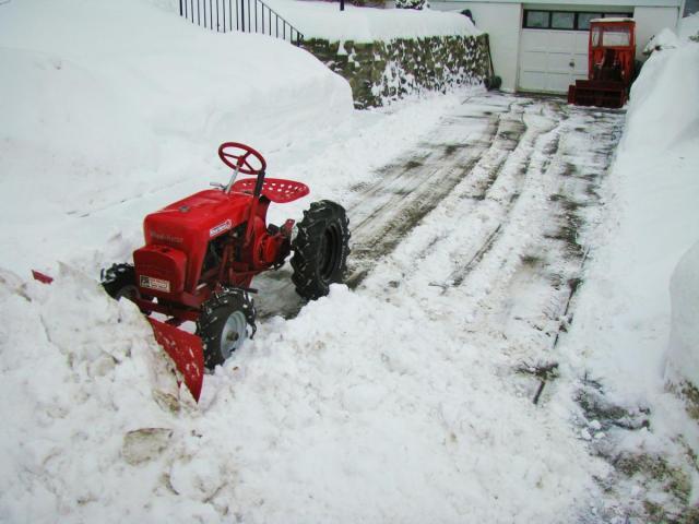

stevebo-(Moderator) 8,604 #12 Posted February 5, 2015 I'm sure it's been done. There are some members here that use different products to keep the patina and accent the age feature of their machines. Some use WD 40 and some use motor oil to preserve them. Check out the photo gallery and search some other threads for more info. Our Moderator Stevebo is a fan of the oil. Maybe he will post some pics for you and share his thoughts. Here are a few examples.... 4 Share this post Link to post Share on other sites
slammer302 2,156 #13 Posted February 5, 2015 Wow stevebo those are sum great looking machines Share this post Link to post Share on other sites
Old Ways 30 #14 Posted February 5, 2015 I agree --dang, those are some beautiful old original machines! Share this post Link to post Share on other sites

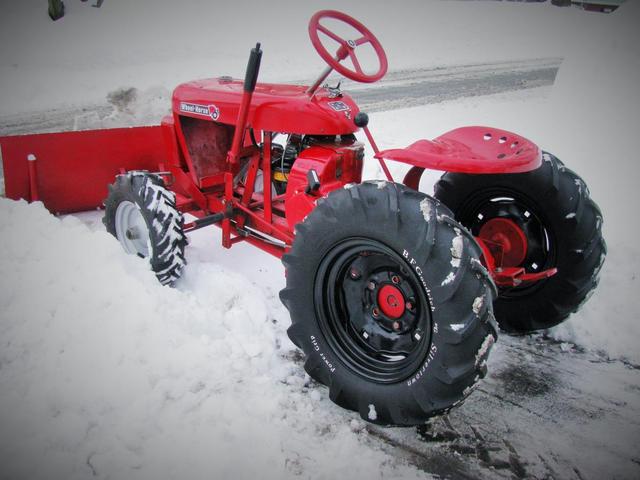

AMC RULES 37,254 #16 Posted February 5, 2015 Nothing but Mothers aluminum and mag polish on this one. Share this post Link to post Share on other sites

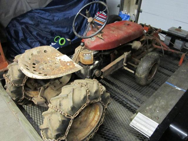

mowinman2 45 #17 Posted February 6, 2015 Stevebo, what do you use on yours? Oil? Rags? I really like how they turn out. Im a huge fan of original paint and patina. Im hoping this will work out nicely on my newly acquired RJ-35 Share this post Link to post Share on other sites
stevebo-(Moderator) 8,604 #18 Posted February 6, 2015 I typically paint the rims with a brush using semi gloss rusto and it seems to give the look I want. I am not looking to make the rims too glossy but clean. I then use miller's tire paint and paint the tires. On the paint I have wet sanded and/or scotchbrite pads. I have used new motor oil, old motor oil, WD-40 and Marvil Mystery oil. I tend to like the mystery oil sprayed out of a bottle because I can get in into the areas I cannot reach with a rag. I can be dirty but I like the look. 3 Share this post Link to post Share on other sites

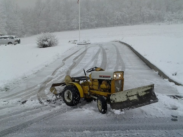

Old Ways 30 #19 Posted February 6, 2015 (edited) I know it's not a horse, but this one is all-original '64. Just a few hours with a rag, some elbow grease, and 5w-30. Turned out beautifully, and sparkled in the sun. Could see your reflection in the hood and didn't leave much, if any, residue. Edited February 6, 2015 by Dane in PA Share this post Link to post Share on other sites
stevebo-(Moderator) 8,604 #20 Posted February 6, 2015 She looks like she can push some snow with that weight out back. 1 Share this post Link to post Share on other sites
Old Ways 30 #21 Posted February 6, 2015 She looks like she can push some snow with that weight out back. Not to hijack the thread, but it also had wheel weights mounted inside the hubs. I estimate the machine's weight to be about 1300lbs in that configuration. It didn't have chains on it, and would push 6" of the wet-heavy stuff straight up that driveway --which is about 80' long and an incline of about 35 degrees. Can't say I miss it, though. Wasn't fun to work on --not that it really ever needed it. I prefer my small, nimble tractors. 1 Share this post Link to post Share on other sites
