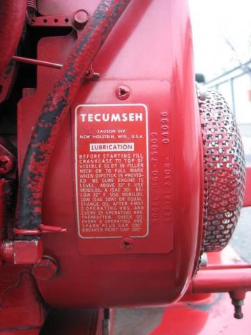

formariz 12,352 #2 Posted February 3, 2015 I don't know if this helps but this is on my all original 653 Share this post Link to post Share on other sites

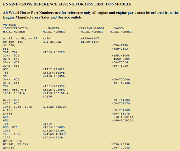

TT-(Moderator) 1,169 #6 Posted February 3, 2015 Not sure if this was 603 or 33R: *not responsible for mistakes on the list I posted - and I know there are a couple. 1 Share this post Link to post Share on other sites
