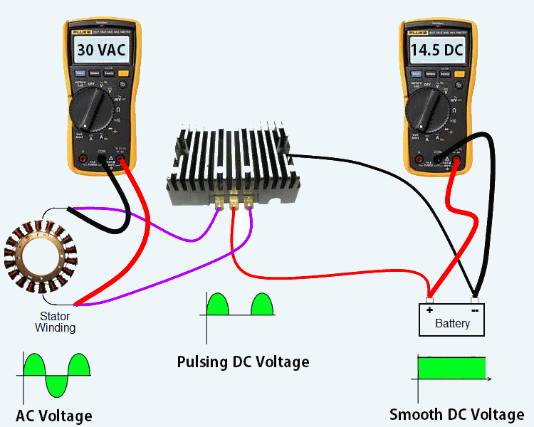

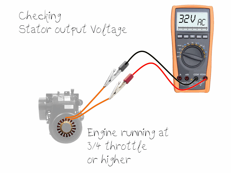

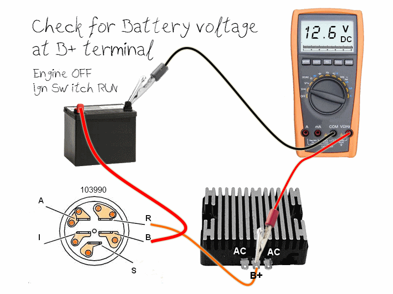

gwest_ca-(File Mod) 11,393 #21 Posted February 3, 2015 This 1977 wiring diagram should match what you have. Star washers work well under bolts and nuts as the teeth will usually penetrate the paint layer or just sand off a small area so there is metal to metal contact. A smear of grease on the spot should keep future corrosion at bay. You could check the voltage across the battery posts if you have a digital multimeter. Then move the negative test lead to the case of the regulator. Should have the same reading if the ground is OK. Try it again after you get it running as resistance can change after a load is put on the system. Another test Record the voltage across the battery posts with the key in the run position but the engine not running. Now move the red test lead to the Battery + terminal of the regulator. Should have the same reading and if not fix that. This checks the path the charge current takes to get to the battery. A regulator needs to see battery voltage before it can regulate the charge current. Garry Share this post Link to post Share on other sites
JustinW.73 224 #22 Posted February 3, 2015 Ya sounds like a charging problem. You can test the whole charging system (stator, regulator, and wires) just simply by checking the battery before running, during and after. It should dit at least 12 volts, and when running be around 14.5 volts is a good charge, and when off it should be higher than the resting voltage before running. To test if the regulator if it has a good ground put it on the continuity test on the multi-meter. Hope this helps! Share this post Link to post Share on other sites
