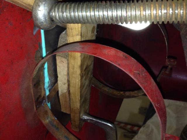

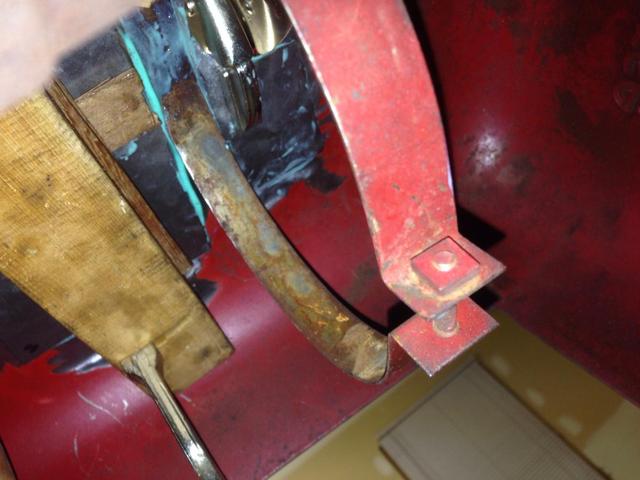

AMC RULES 37,259 #26 Posted February 1, 2015 I wish I took a before pic of mine but I didnt. Mine was completely tore out where the front tank strap is, I took my time and welded it up as long as you don't put to much heat I one spot you will be ok. Also you could put a piece of brass under it to help absorb the heat. Just do a tack here and a tack there till it done. Do you have a pict of your finished repair you can share here? Share this post Link to post Share on other sites
jeremi3210 747 #27 Posted February 1, 2015 I did find a pic that you can kinda see how bad it was. Share this post Link to post Share on other sites
jeremi3210 747 #28 Posted February 1, 2015 Here is a after pic. 1 Share this post Link to post Share on other sites
51Chevy 66 #29 Posted February 2, 2015 I got it glued up tonight 1 Share this post Link to post Share on other sites
