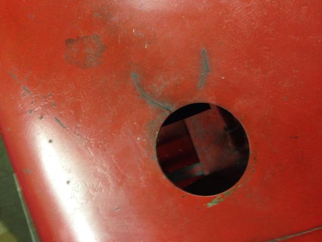

51Chevy 66 #1 Posted January 29, 2015 My hood on my Rj 35 is cracking from the gas tank what do you guys think I should do? Share this post Link to post Share on other sites

VinsRJ 723 #17 Posted January 30, 2015 (edited) I personally would not apply heat to a RJ hood... only as a last resort (tack welding or brazing). If you are not completely careful and pay very close attention to the heat, you will end up with nothing but a wavy mess... which in most cases cannot be corrected due to the thin guage steel that was used. There are plenty of destroyed hood pics if you google... and keep in mind these hoods are not GM quarter panel quality so all those handling therories can be just thrown out the window. What I have done in the past with a crack like yours is to epoxy a piece of 22 guage sheet steel in front of tank strap and one behind the front tank strap. 22 guage steel I find is the same thickness of the strap(s) so there will be no issue with the tank riding lower in the hood. I would go about an inch and a half wider than the cracks themselves (all the way around) with the patch steel and make an appropritate relief curve for the tank filler neck hole. I have done this a number of times and never have had an issue. One thing most people don't think about... Do not fill a RJ tank to the brim with gas... just fill the tank about a 1/4 of the way at any given time... and try not to travel (trailering) a RJ with gas in the tank... trust me, your hood and tank straps will thank you... I believe SteveBo learned the hard way about this therory one time. BTW: Thank you to all that have watched my vids... I very much appreciate your interest! Edited January 30, 2015 by VinsRJ 1 Share this post Link to post Share on other sites

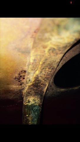

51Chevy 66 #18 Posted January 30, 2015 But how can I do that? Like I said I can't get to the cracks from the bottom of the hood, I took a where the are under the hood Share this post Link to post Share on other sites

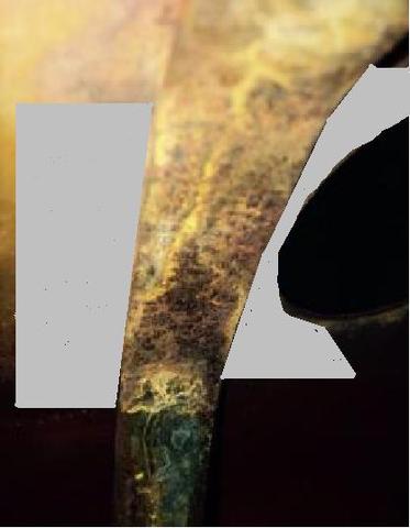

VinsRJ 723 #21 Posted January 30, 2015 (edited) This what I would do... I would not remove the strap... I would sand down/clean the area where the metal is to be epoxy, in front and in back of the strap... at the end of the day you need to eliminate the flex in the hood. By placing the sheet metal in the positions noted you will esentially eliminate any flex in the hood and stop the metal fatigue cracking by way of the added support. By making your patches an inch to an inch and a half wider than the cracks themselves, you will be supplying the load over a large area: 1) stiffening the hood and 2) providing extra stability for the tank strap itself. Sorry about the crappy pic... all I could do in 5 minutes with a mouse and paint. Edited January 30, 2015 by VinsRJ 1 Share this post Link to post Share on other sites
