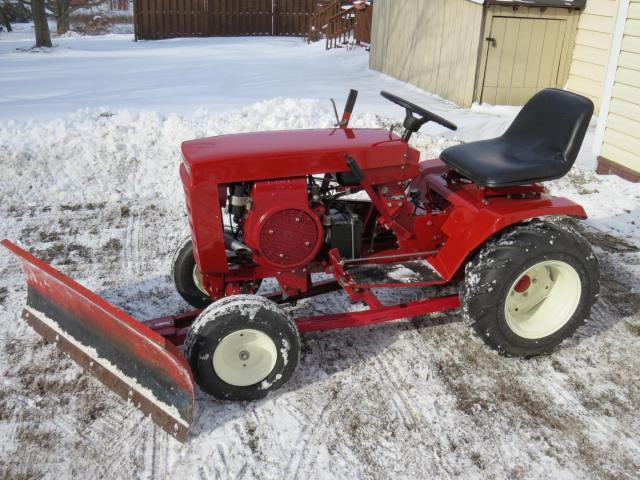

gwest_ca-(File Mod) 11,508 #2 Posted January 26, 2015 Here is the first one and the last one Garry Share this post Link to post Share on other sites

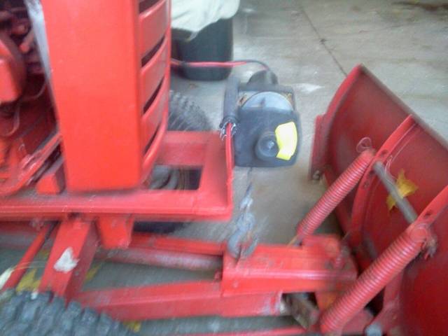

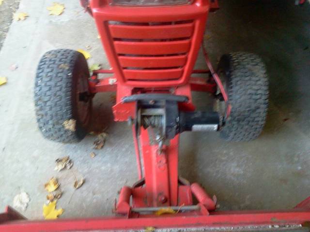

dodgemike 52 #3 Posted January 27, 2015 This may not be the conversion You mean, but it has worked well. It is on my C121. Sent from my SCH-S720C using Tapatalk 2 2 Share this post Link to post Share on other sites
rustykan 140 #4 Posted January 27, 2015 This may not be the conversion You mean, but it has worked well. It is on my C121. Sent from my SCH-S720C using Tapatalk 2 Do you have any more photos? Share this post Link to post Share on other sites
dodgemike 52 #5 Posted January 27, 2015 Here you are. Just an angle iron Frame and a Warn winch. This Tractor plows a big gravel drive in Winter and maintains it in summer. In 8 yrs. The only thing i had to Replace is the switch. I mounted The switch on the lift lever with a Home made bracket. Sent from my SCH-S720C using Tapatalk 2 Share this post Link to post Share on other sites
