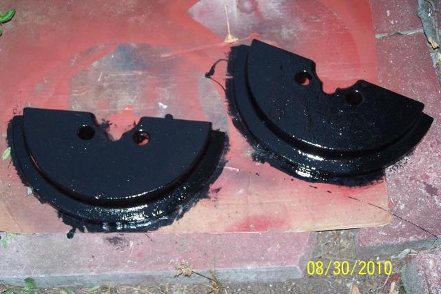

baerpath 517 #3 Posted January 26, 2015 (edited) Yes there are special weights for the GT14's. I have a couple sets I'll see if I can get a picture or maybe someone can post one They mount to the inside of the hub Edited January 26, 2015 by baerpath Share this post Link to post Share on other sites

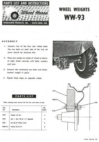

Lane Ranger 11,641 #4 Posted January 27, 2015 (edited) This is the weight set you are looking for your GT -14. They were made for the 15 inch 4 bolt wheels used on the Wheel Horse 953, 1054 and GT-14 wheels. They are mounted in the inside of the wheels one half at a time . I have two sets and they are on 1964 Wheel Horse 1054 tractors. You can click on this scan to expand the view : Edited January 27, 2015 by Lane Ranger 1 Share this post Link to post Share on other sites
