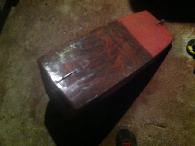

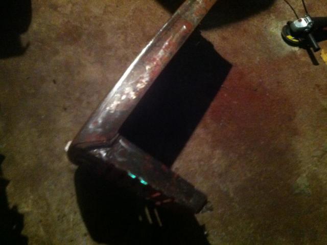

Crown Vic P71 20 #1 Posted January 25, 2015 Hello everyone! I am commencing my first restoration on a '68 Charger 12. After 2 years I am finally going to begin in hopes of having it finished before the big weekend in June!! So far, I have gotten the engine running and began stripping the hood of paint to see what kind of shape the metal was in under the 3 layers of paint that was on it. I will keep this thread updated as progress continues and will reach out with any questions. Being said, my first is, What is the best color spray paint to use and after sanding down, what is the best way to prep it for primer, then from primer to paint. Thanks for the input! And here are a couple pictures and a video of it running from last night. trim.D1D6EA2A-7DFE-41E9-925F-8C6DC8920C32.MOV 2 Share this post Link to post Share on other sites
