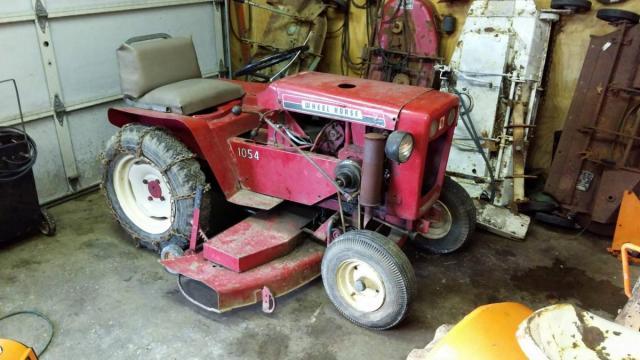

rustyoldjunk 127 #1 Posted January 22, 2015 I need a picture or diagram of the back of a 953 ignition switch. Would also like to see what the key looks like. I need to figure out how to wire the switch. Someone rewired this one with a newer switch and a solenoid. Pay no attention to the "1054" decals someone put on it. It is a 953. 1 Share this post Link to post Share on other sites
953 nut 62,159 #2 Posted January 23, 2015 Love the 953s. The ignition switch is a 2 wire no/off key switch, the starter push button that looks like a headlight dimmer switch from a '70s or earlier car. If you look at the exploded view of the dash area in the manual they will both be shown. Good luck. 1 Share this post Link to post Share on other sites
rustyoldjunk 127 #3 Posted January 23, 2015 I downloaded the manual a while back and while the wiring is there it doesn't show the terminals on the back of the switch so thank you 953 nut,that is what I needed to know. I have a old school ignition switch that is not original but will work and for now that is what I plan to use. Share this post Link to post Share on other sites
