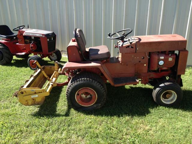

squonk 45,590 #6 Posted January 11, 2015 (edited) The blade I have has the teeth to break up the hard pack and a rack area to weigh it down with cinder blocks. A WH cultivator is light and will just bounce on the ground Edited January 11, 2015 by squonk 2 Share this post Link to post Share on other sites

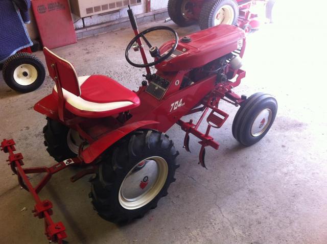

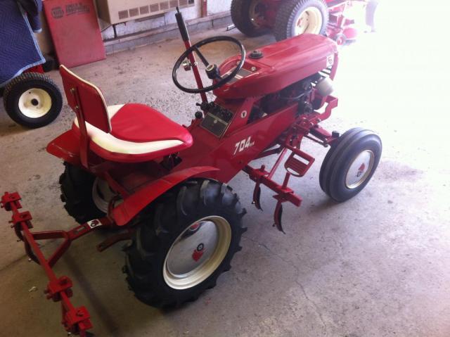

KC9KAS 4,746 #11 Posted January 11, 2015 I was thinking box blade.... I have used my cultivator to loosen the gravel before using the grader blade to level. Now that I think about it, I used the cultivator quite a lot to "remove" weeds in the gravel drive. You might be a "Redneck" if you have to mow your drive-way. 1 Share this post Link to post Share on other sites

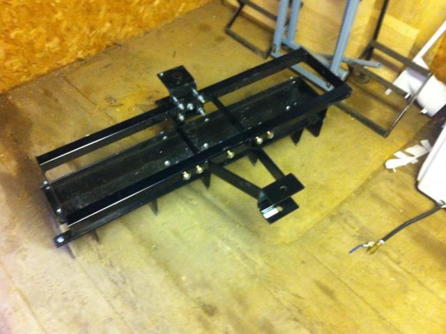

Don1977 605 #12 Posted January 11, 2015 Here is a pulverizer I built for sowing grass, that is why the roller is on the back. It's really to heavy to lift with a manual lift. It would loosen the gravel drive. 4 Share this post Link to post Share on other sites
