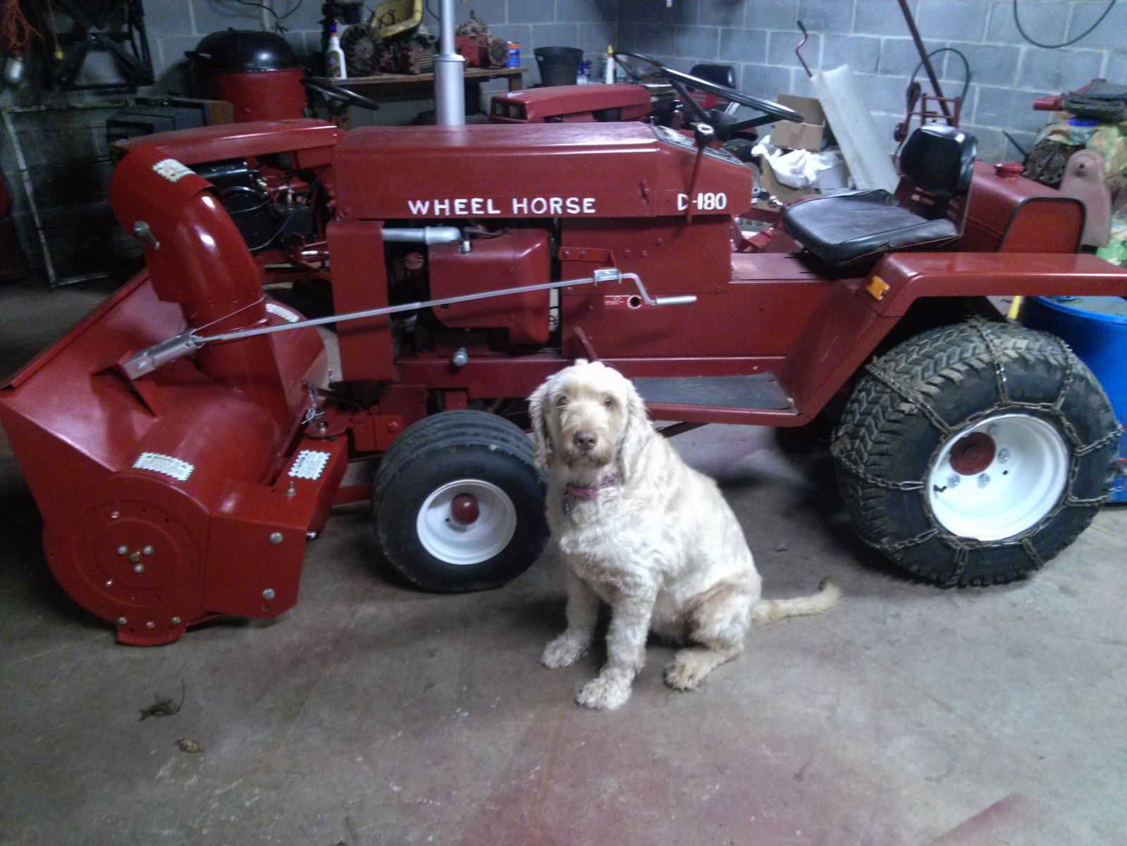

Trouty56 568 #5 Posted January 8, 2015 The chute adjuster is kind of telescopic...a square tube within a square tube.....it attaches to the cable turning jigger with an eyehook so you can easily take it off.....then it has a bracket to attach to the left side of the tractor.....you can see it here above Lacey's pretty head..... [ Share this post Link to post Share on other sites
