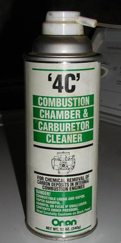

P3x 57 #9 Posted February 2, 2015 Purchased a 520 about 4-5 years ago and was running into a lot of running issues. Being new to WH tractors did the typical TS items, started using Sea Foam as recommended on this site. Was hesitant to take the top carb body off to clean it internally as I could not find a vendor that sells just the carb body gasket and did not want to pay the price of a complete carb OH kit to get one. Would get it running OK, only to have the RPMs hunting/engine running rough a couple of week's later. Went to the local Cummings/Onan dealer to check on Carb OH Kit prices and the Parts guy recommended a spray cleaner (Onan) their mechs used - "4C" (Combustion Chamber & Carb Cleaner). Spray it in the carb with no disassembly required. Having tried many miracle "Mechanic in a Can" products over the years figured I'd buy a can to try as Onan part prices are steep. Amazing stuff. When ever it starts running rough/RPMs start hunting (which seems to be often for P220Gs) this cleaner has resolved the issues without taking anything apart other than removing the air cleaner housing. Sounds like a good deal for all 520H owners suffering from dirty carbs - Yes? Now the bad news, Cummings/Onan stopped making/selling it with no equivalent product. Searched the web and cannot find any info about it available - suspect it may be due to government regulations. Posting a picture of one of the last cans I have to rule out it was only a dream... Hope someone can shed some light on this mystery and knows a source I can find more to quench my addiction! P3x Share this post Link to post Share on other sites
