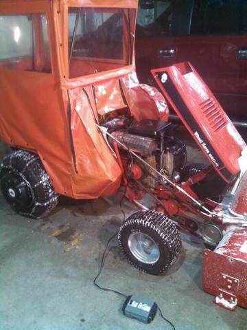

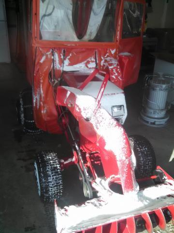

cheesegrader 436 #30 Posted January 10, 2015 Let's see..... Brutally cold garage and tractor covered with snow? Check! Snowblower and cab attached so you can only get the hood half open? Check and Check! Intermittent electrical problem that makes you want to stab your own eyes with a multi-meter lead? CHECK! I feel your pain. As much as I love these tractors, there are some major design flaws. The electrical system in general, and the fuse block in particular come to mind. I still think you have a short in or around the fuse block, and I wouldn't spend a bunch of time searching for other issues until I ripped the %*&%#$#!!ing thing out. 1 Share this post Link to post Share on other sites
