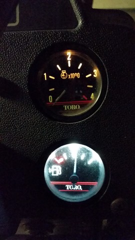

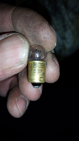

WHX?? 58,307 #31 Posted December 1, 2015 Working on the 520H and a couple of these gauge lights was burnt out. Also noticed where the sockets on the gauge was geting hot. Keep in mind that 0n 520's the gauge lights are on all the time. Why WH didn't wire them to the headlight switch is beyond me. Share this post Link to post Share on other sites
gwest_ca-(File Mod) 12,511 #32 Posted December 1, 2015 The tachometer bulb was too hot and they replaced it with a 53 bulb. Garry Share this post Link to post Share on other sites
WHX?? 58,307 #33 Posted December 1, 2015 Ordered four of these here https://www.superbrightleds.com/moreinfo/ba9s-ba7s/ba9s-led-bulb-4-led-ba9s-retrofit-car/6/ Difference is amazing and the glare is not as bad as the pic Right Garry thats the one that was starting to melt - Thanks 2 Share this post Link to post Share on other sites
