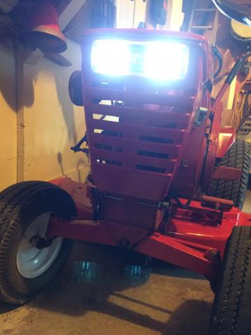

clip 185 #1 Posted January 2, 2015 (edited) When I got my Work Horse, I found out one of the 4411 headlights was burned out. I've always been critical of tractor headlights, from the 1157s on my Cub Cadet to the 4411s on the Farmall, and the lone 4411 on the Horse sent me over the edge. Seemed like if I squinted I could see better than with the headlight on. I didn't want to pay the $74 for the Trilliant direct replacement and the market is flooded with cheap Chinese LEDs, so I picked up a set of 4" round "off-road" type LEDs from Amazon for $35. I made sure to get the 30 degree spot pattern as I've always been dissatisfied with how the LED beam never throws very far. Got to work on the project a few nights ago and it went smoothly by my standards. Quick summary: Bent the two tabs on each headlight hole (intended to orient the 4411) backward until I was left with a good 4" round hole. No sheet metal has been cut off or modified such that the original 4411s couldn't get dropped back in. I test fit the new lamps and found they were a great interference fit, so I grabbed a C-clamp and squeezed them into place. Because the new lamps are meant to mount on the exterior, they have a slight 1/2" hood on the top to keep weather off the lenses. I intended to cut it off eventually but left it on during test fitting, and it worked well so I kept it around. I removed the headlight bezels during fitting and haven't decided if I like them on or off. I think I get more light off but the grill looks nicer complete. Had to make a change to the wiring harness, going from a double spade connector to a single, and covering it with a length of shrink tube to prevent shorting. I might switch to a double bullet connector but again, I'm leaving well enough alone. Took it for a ride around the yard and the lights didn't drop out, but I cut a piece of aluminum to back them up just in case. I'll try to get some beam shots and a finished picture tonight. I'm not quite sure if I like the 30 degree beams vs the 60 degree floods (haven't had a chance to try them), but the 30s definitely throw like they're supposed to. I think once I aim them properly, I'll get the spill I want. Also, the light pulses at less than operating speed so I think I'll run a direct line from the battery, switched like stock, so it receives a constant 12v up to 13.5v when charging. Edited January 3, 2015 by clip 2 Share this post Link to post Share on other sites

clip 185 #7 Posted January 3, 2015 (edited) Took a few sets of pictures, the first are at 1/15 sec shutter speed, ISO 3200, f1/4. This is as close as I could get the picture to resemble what I was seeing. The fence line ends 90 feet away, that rock is about 150 feet away, and the low brick wall way out there is about 300 feet away. These were taken at operating speed. From 90 feet At 150 feet you can see the trees directly to the right of the rock are being lit by my headlights, but the mailbox is catching someone's headlights down the road. Here's the control shot at 1/30 sec, everything else constant. Only light is from the outdoor light on the shed. 1/30, operating 1/60 sec, idle 1/60 operating 1/60 at grill Edited January 3, 2015 by clip 1 Share this post Link to post Share on other sites

doc724 925 #9 Posted January 3, 2015 Clip, What actually holds the new lights into the hood, just the interference fit to the sheet metal? Share this post Link to post Share on other sites
clip 185 #10 Posted January 3, 2015 Doc, it had been an interference fit for wiring, testing and the first ride around the yard (I was impatient ), but the next day I secured everything with a 14" 1x1/8 aluminum flat bar. I held that on with 2.5" 1/4-20s in the original 4411 retaining clip locations. Will provide a picture soon. Share this post Link to post Share on other sites
doc724 925 #11 Posted January 3, 2015 Clip, thx. I don't need a pix. Based on your description I can visualize what you did. That is a good low cost solution. Nice clean install as well! Share this post Link to post Share on other sites
clip 185 #12 Posted January 4, 2015 For future reference, a picture of the aluminum bar and cable management. 4 Share this post Link to post Share on other sites
clip 185 #13 Posted January 6, 2015 After studying the wiring diagram, I noticed the headlights are receiving AC instead of 12v DC. Suspect this is why they flicker at idle. Ordered a 10A bridge rectifier to convert to DC in hopes that'll end the flickering. I think they'll still dim at idle but will hopefully be constant. The other option is to run the lights directly from the battery or the DC accessory terminal on the keyswitch, but I think both of those get their current from the DC rectified lead from the alternator. I'd rather use the dual leads and keep the DC lead free to charge the battery. Share this post Link to post Share on other sites

clip 185 #17 Posted March 18, 2015 Never got to put the rectifier on, but at 50% throttle and up the LEDs are flashing too quickly for me to tell so it doesn't bother me. Also seems like the diode is blocking the reverse current sufficiently. If I had to do it again I'd probably go with the 60 degree flood beams, or put a light bar above the mule drive for general area lighting. After aiming the 30 degree spots, I've got a wider beam spread but the 60s would mean a little less work to do. Share this post Link to post Share on other sites
