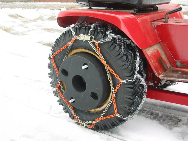

pfrederi 18,696 #15 Posted December 30, 2014 If you have packed snow/ice under fresh snow you will have problems with just ags. Especially if you are trying to back up. Ags are directional. If your driveway clears off between storms ags alone may work. I have a Farmall M with about 1250 lbs of beet juice in her rears and front plow. She can push in deep snow but if there is Ice under it not so well and when you raise the blade and try to back up forget it. I also have a DC3 Case with back blade and 600lbs of weights. She has duo link chains and I would not try plowing it without them. (you get one of these stuck and recovery is a bit of work) I am with Ken. They Electro 12 with her limited slip rear end is a plowing beast!!! Share this post Link to post Share on other sites
Kelly 1,033 #16 Posted December 30, 2014 Another thing most people don't understand or think about, and the last pic made me think to share, the narrower the tire the better the grip you will get, it relates to PSI pounds per square inch, a fat tire spreads your weight out over a larger area, defeating the purpose of more weight, were a skinny tire puts it in a small spot and in a way makes it act like your tractor is heavier, wide tires in mud or dirt is fine but not ice and snow. 3 Share this post Link to post Share on other sites

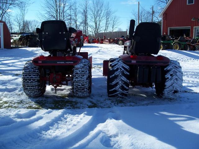

Kelly 1,033 #19 Posted January 1, 2015 Well I don't stick to the narrow tire rule myself, the 520 with 26x12x12 ags is my plow tractor with over 200lbs hanging on the back of it, the other 520 is my blower tractor with 23x10.5x12 turfs with cleated 2 link chains and 55lbs wheel weights both do great till ice builds up and the then ags don't cut it, the chains pull through everything, if I had a choice turfs and chains will win This was last year, no real snow this year 1 Share this post Link to post Share on other sites
