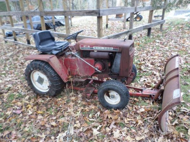

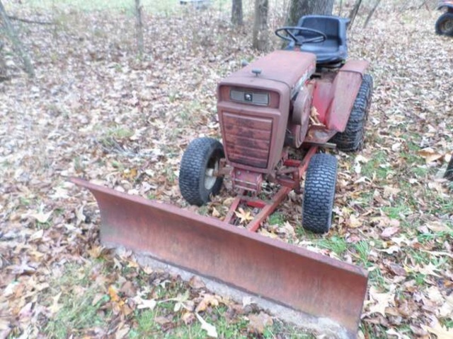

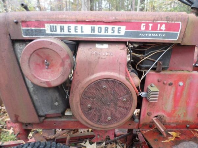

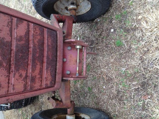

953 nut 63,543 #7 Posted December 30, 2014 Nice GT-14! You have the mid-mount-attachment bracket and the mule drive attachment point already, all you need is warm weather and a mule drive and you are ready to mow! If the PO can't find one they can be found on ebay. 1 Share this post Link to post Share on other sites

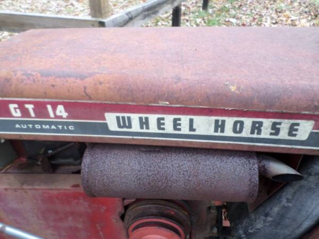

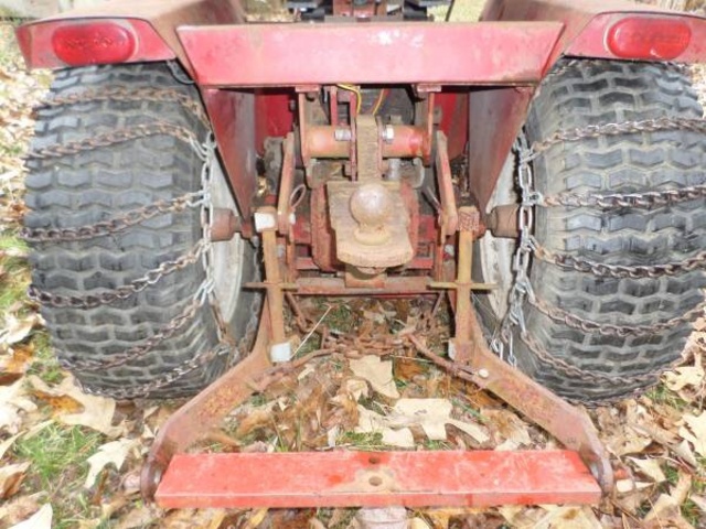

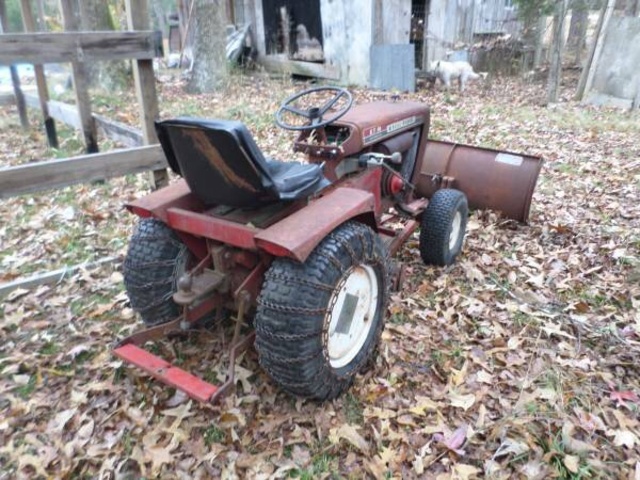

Theroundhousernr 590 #8 Posted December 31, 2014 Hey Tim, That gt14 has had some interesting mods done to it. Nice big quiet muffler. The front tach-o-matic. Newer style mower deck with scalp wheels. Manual PTO, original would have been an electric PTO. PLUS a three point . All some nice upgrades that I have thought about doing to mine to open up to more versatility. If everything was done right , should make for a nice little tractor! Good Luck 1 Share this post Link to post Share on other sites

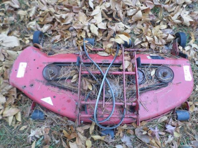

Racinbob 12,503 #9 Posted December 31, 2014 (edited) That mower deck is for a newer model on tractors that had the front mule drive. Apparently the PO made the switch to the newer deck and mule drive which I think is a good thing unless you want a fully original GT-14. I believe he put the manual PTO setup on it too. There's no reason you won't be able to have it working fine with maybe just a little fiddling. Oops! Edit. Sorry roundhouse. I really just repeated what you said. I need to read ALL the posts better. Edited December 31, 2014 by Racinbob 1 Share this post Link to post Share on other sites
Theroundhousernr 590 #10 Posted December 31, 2014 No apology needed. We all think a like anyway. Most of the time.... lol. I was just glad to see some pictures of someone else that has done what I have been thinking about doing to my GT14. With some time taken and paint, no one would every no the difference. 1 Share this post Link to post Share on other sites
gwest_ca-(File Mod) 11,918 #11 Posted December 31, 2014 My ignorance is showing as I never noticed the upgrades. Have a couple of WH decks but have never used them. The mule for the front would look like this one Looks like you have a 48" deck. Garry 1 Share this post Link to post Share on other sites

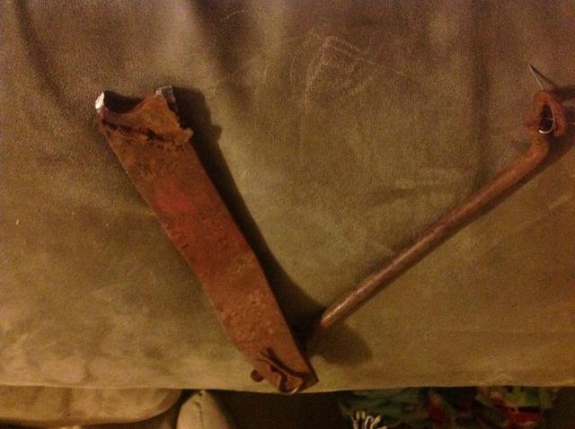

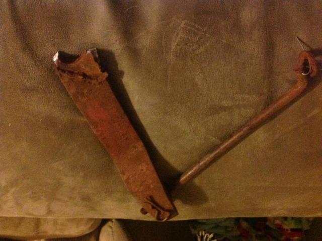

Tim1986 3 #17 Posted January 20, 2015 I'm happy to say I'm finally a proud owner of a wheel horse!! I picked it up last night. It was dark when I got home so I had to wait until today to play with it. I hate to admit that it took me half an hour to figure out how to hook up the mower deck after I figured it all out I decided to take it for a spin. Two minutes later I hit a stump I didn't know was there and I broke the shaft that goes to the lift going to tear it apart this weekend and see if I can find someone to weld it back together for me. Looks like it may have been welded before. Is there anything I can do to prevent it from breaking again? Other than avoiding stumps lol. is this a part I can buy if it's not fixable? Share this post Link to post Share on other sites
953 nut 63,543 #18 Posted January 21, 2015 Glad to hear you got it, sorry about the broken lift arm. You already discovered the problem, don't hit stumps! I like to hang the deck off a chain rather than a solid link, saves a little impact transfer. Good luck and keep us posted. Share this post Link to post Share on other sites
Theroundhousernr 590 #19 Posted January 21, 2015 I'm happy to say I'm finally a proud owner of a wheel horse!! I picked it up last night. It was dark when I got home so I had to wait until today to play with it. I hate to admit that it took me half an hour to figure out how to hook up the mower deck after I figured it all out I decided to take it for a spin. Two minutes later I hit a stump I didn't know was there and I broke the shaft that goes to the lift going to tear it apart this weekend and see if I can find someone to weld it back together for me. Looks like it may have been welded before. Is there anything I can do to prevent it from breaking again? Other than avoiding stumps lol. is this a part I can buy if it's not fixable? Ouch! I have never had mine break but I hear this is not fun to pull out to fix! I believe a quote by a member here was something along the lines of " they must have built the tractor around the rockshaft.... " Good luck! Hope all goes well. Share this post Link to post Share on other sites
