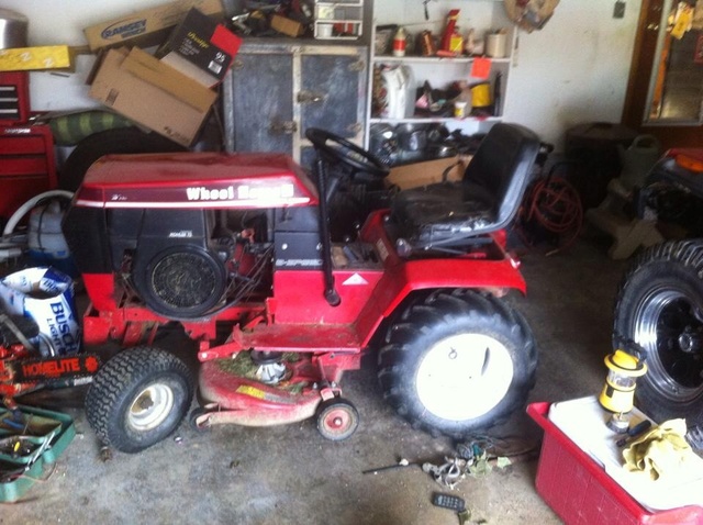

wheel horse man 56 #1 Posted December 28, 2014 (edited) I just bought a work horse gt1800 rolling chassie i tired of my 8 speed 312-8 i have a snow blower and tiller and like to have hydrolic lift and hydro trans the gt1800 has no engine belt guard is there hydro lift is there but sheet metal is gone pretty much just a parts tractor it has a eaton 1100 can i make my 312-8 into a 312-h Edited December 28, 2014 by wheel horse man Share this post Link to post Share on other sites

wheel horse man 56 #6 Posted December 28, 2014 I get pics when i go to pick it up but i checked it out i did not see any thing missing other then the engine and the seat the fender pan and hood was all attached this a full complete tractor the guy i bought it from just wanted the engine for a golf cart he is leaving me the pto and drive pully belt and gauards Share this post Link to post Share on other sites
Kelly 1,033 #7 Posted December 28, 2014 Swap your engine, wiring and your PTO parts to the gt, everything should be a bolt in, now depending on what year your 312 is you may have to drill a few holes to mount dash lights or swap upper dash's, all the steering will interchange so you can swap to the best parts, your 312 may have 6" front wheels so the spindles will not be the same if so, but most people want the bigger 8" anyway, the gt will have the 8.5 wide 520 style rear wheels with 23x10.5 tires that is a bonus, if I had them both setting here I could have the swap done in less than a day and that is taking my time checking everything over as I go. Share this post Link to post Share on other sites
wheel horse man 56 #8 Posted December 28, 2014 Kinda low budget build here but i hate to tear my 312-8 apart Share this post Link to post Share on other sites

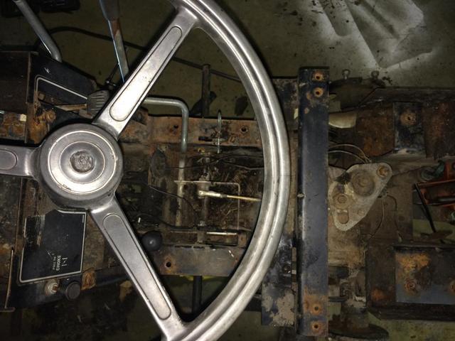

wheel horse man 56 #11 Posted December 28, 2014 (edited) Lol front weights not for sale going to my personal collection. Buy the way i paid 120$ for the tractor came with the deck 42inch blade rear weights and the front wheel horse weights the frame on the tractor is twisted and broke thats why i want to use my 312 8 frame i just decided to switch transmission and restore the 312-8 to a 312-H. I just want to know what parts will i have to change buy the way snow blade for sale . I going to make these a project restoration i post pics of it as i start it i calling it project 312-8 / H conversion Edited December 29, 2014 by wheel horse man Share this post Link to post Share on other sites
baerpath 517 #12 Posted December 29, 2014 I would straighten and plate the frame or pickup another frame. I wouldn't take the 312 apart for what little you need. I'd find another twin and redo it. Your tractor but my thoughts on it Share this post Link to post Share on other sites
Callen 64 #13 Posted December 29, 2014 where is it broken? Share this post Link to post Share on other sites
wheel horse man 56 #14 Posted December 29, 2014 Right in front of transmission plate with the 4 bolts Share this post Link to post Share on other sites
WH nut 553 #15 Posted December 29, 2014 Right in front of transmission plate with the 4 bolts That can be fixed easy enough, just cut a plate to go in front and weld in and rebolt. Share this post Link to post Share on other sites
baerpath 517 #16 Posted December 29, 2014 Fairly common repair lot's of threads on here about doing it. I have a 18hp briggs that would work in it I can drop off in Springfield while I'm at the pull Share this post Link to post Share on other sites

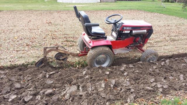

diamondred 63 #22 Posted January 2, 2015 (edited) yes I would put it on the geared tractor,but its nice to have a hydro or 2 for other duties like snow removal,mowing etc,anything other than tilling,not sure how they do pulling a soil turning plough My 520h will pull a Brinly 10" plow, didn't even have a problem with turf tires. But gonna go back to the 314-8 for pullin' a plow, pushin' a plow, and tilling. Just like that "same speed everytime thing". Edited January 2, 2015 by diamondred Share this post Link to post Share on other sites
