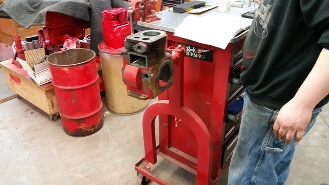

Shynon 7,533 #1 Posted December 25, 2014 During my recent project I decided to build an engine stand for Kohler single cylinder rebuilds, this is what I came up with. 19 Share this post Link to post Share on other sites

Geno 1,930 #4 Posted December 25, 2014 Very nice Shynon, should make things a lot easier. Share this post Link to post Share on other sites
Firpo701 407 #5 Posted December 25, 2014 That looks very effective! Guess I now know what my next fab project will be! Share this post Link to post Share on other sites
MaineDad 87 #6 Posted December 25, 2014 That is a great idea! Share this post Link to post Share on other sites
JC 1965 1,536 #7 Posted December 25, 2014 Wow !! I like that !! Share this post Link to post Share on other sites
Coadster32 793 #8 Posted December 26, 2014 Cool idea!! Share this post Link to post Share on other sites
bean 85 #9 Posted December 27, 2014 Nice! That will make camshaft installation a lot easier Share this post Link to post Share on other sites

Dirtdog524 61 #12 Posted January 17, 2015 That looks professional! you need to market that setup Share this post Link to post Share on other sites
Shynon 7,533 #13 Posted March 5, 2016 Here is my updated engine build stand/station Stainless top/engine tools and parts in drawers. Clean workstation 10 Share this post Link to post Share on other sites

kwalshy 242 #15 Posted February 15, 2018 Very nice! 👍 I wish I had the skills to build a custom stand like that! This might sound like a silly question, and it probably is, but what size bolts should I use when mounting my Kohler K241 to my store bought engine stand if I use the holes that are for the starter? Or should I use the bolt holes on the engine for the bearing plate cover? This is my first rebuild, so I’m learning as I go. Thanks Share this post Link to post Share on other sites
Shynon 7,533 #16 Posted February 15, 2018 use the starter holes, 3/8 Share this post Link to post Share on other sites
