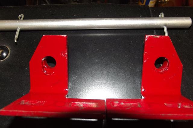

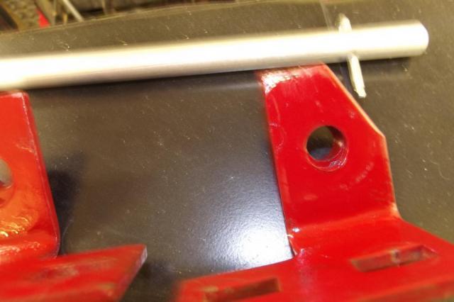

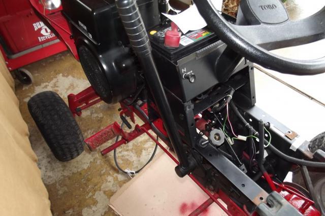

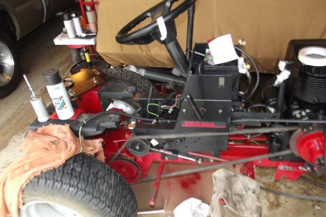

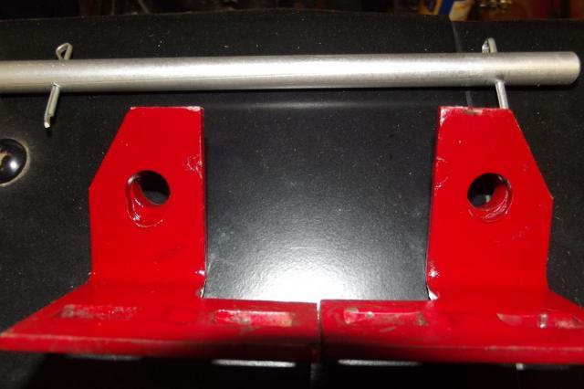

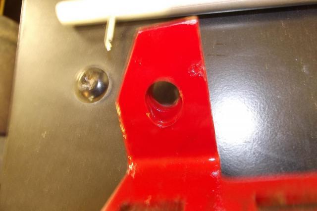

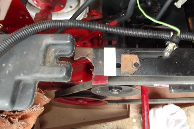

BOWTIE 226 #1 Posted December 24, 2014 WINTER IS HERE AND STARTED WORKING ON 1992 310-8 PROJECT. DISMANTLE SOME OF IT TO CLEAN AND FOUND SOME MINOR PROBLEMS, HOOD HINGES WERE EGGED OUT AND THE SEAT MOUNT HAS METAL FATIGUE. HERE ARE SOME PICTURES. BOWTIE 7 Share this post Link to post Share on other sites

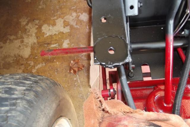

Tankman 3,528 #2 Posted December 26, 2014 Pins for the hood hinges, a common problem, drill 'em out and install bushings. The steel under the pan goin' to need welding. You might add a piece of 16 ga CRS to strengthen the area. Doesn't look too terrible. Keep us updated, the forum wants to see. Share this post Link to post Share on other sites

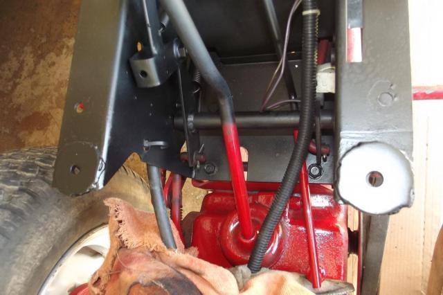

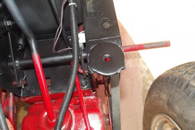

BOWTIE 226 #3 Posted December 26, 2014 I REPAIRED THE METAL FATIGUE WITH 2 WASKERS ON EACH SIDE, WELDED THE ORIGINAL METAL BACK IN PLACE. THEN WELDED ONE WASHER ON THE TOP AND ONE ON BOTTOM. I DID WASHERS ON THE LEFT AND RIGHT SIDES OF THE FRAME RAIL. BOWTIE Share this post Link to post Share on other sites
608KEB 843 #4 Posted December 26, 2014 Looks like it will hold up now! Share this post Link to post Share on other sites

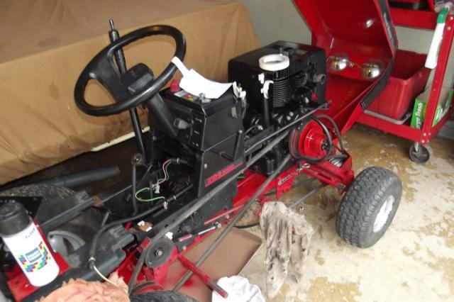

Tankman 3,528 #5 Posted December 28, 2014 (edited) Does indeed look good. Steering wheel top center 'T' has to go! Glen Pettit's new insert looks great! Have fun with your project and, of course, update the forums! Edited December 28, 2014 by Tankman Share this post Link to post Share on other sites
