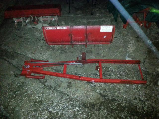

stihl340 7 #1 Posted December 22, 2014 (edited) I have a 417a wheel horse. will this plow fit? what should I be looking for. thanks Edited December 23, 2014 by stihl340 Share this post Link to post Share on other sites
gwest_ca-(File Mod) 11,500 #2 Posted December 22, 2014 Looks like it should fit. What is the model number on the front of the A-frame? The tag looks black in the photo. This is the manual for the blade sold at the time of the tractor Parts list Blades for the C-Series except C-195 and 300 and 400-Series up to the last in 2007 will fit. You also need the quick hitch for the rear tractor axle. Garry Share this post Link to post Share on other sites
rexman72 210 #3 Posted December 23, 2014 yes it will fit the 417 Share this post Link to post Share on other sites
stihl340 7 #4 Posted December 23, 2014 identification number 06 - 42BC01-1967 9095 thanks again Share this post Link to post Share on other sites
rexman72 210 #5 Posted December 23, 2014 that 417 with push that snow all over the place Share this post Link to post Share on other sites
Tankman 3,523 #6 Posted December 23, 2014 (edited) The blade'll fit. Do you have the angle adjust arm and triangular piece for the angle indexing lever? http://www.partstree.com/parts/?lc=toro_consumer&mn=06-48BC01%2C+48%22+Snow%2FDozer+Blade%2C+1984&dn=810224R3-24R30005-0003 #'s 14 & 20? Edited December 23, 2014 by Tankman Share this post Link to post Share on other sites
