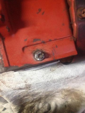

Bert 760 #1 Posted December 21, 2014 Hello folks, like the title says Ive got a stuck drain plug and was hopping for some suggestions as to how to remove it. When I got this engine the plug was in bad shape and my attempt to remove it with a pipe wrench made it worse Even a bit of heat didn't work. I really don't want to drill it and risk getting shavings in the case. Thanks in advance for any and all thoughts and suggestions Share this post Link to post Share on other sites

Digger 66 3,523 #4 Posted December 21, 2014 Hello folks, like the title says Ive got a stuck drain plug and was hopping for some suggestions as to how to remove it. When I got this engine the plug was in bad shape and my attempt to remove it with a pipe wrench made it worse Even a bit of heat didn't work. I really don't want to drill it and risk getting shavings in the case. Thanks in advance for any and all thoughts and suggestions IMG_0690.jpg Get yourself a left-handed nut slightly smaller than the buggered portion , tap it on while turning & should lock on . 4 Share this post Link to post Share on other sites

Bert 760 #18 Posted December 27, 2014 I got the plug out by heating it with map gas and oxygen, this wasn't my plan but the idea hit me so I tried it. Last time i used propane. I don't know why it was so tight? Never had this problem with any others. Had to get it glowing and it still needed a lot of force. 1 Share this post Link to post Share on other sites

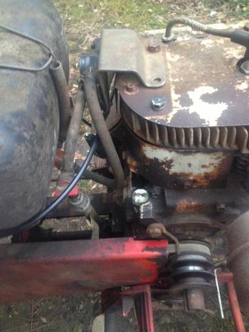

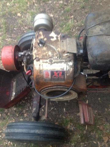

Bert 760 #20 Posted December 28, 2014 Im glad that you were able to get it removed. Dealing with problems things like that can be so frustrating and stressful. Just a thought, I always put a dab of anti seize compound on drain plugs Thanks, and yes very frustrating. Anti seize is a good idea for a plug but sense this engine has two oil drains I'm gonna use plumbers pipe and a brass nipple to run a vacuum fuel pump. Ive done this before and it looks ugly but works great Heres a pic of my HH100 with a briggs fuel pump powered by the extra drain. Its also has a 8hp kohler carb on it. I did this a few years ago when I was broke. I used what I had or what was cheap, its run so good I don't wanna go back to original parts. 1 Share this post Link to post Share on other sites
Mr. 856 170 #21 Posted December 28, 2014 wait a minute......you got a techy running a briggs pump with a kohler carb????!!!!!!! And it runs good? Share this post Link to post Share on other sites
Bert 760 #22 Posted December 28, 2014 wait a minute......you got a techy running a briggs pump with a kohler carb????!!!!!!! And it runs good? Yes thats correct, it took a bit of fine tuning to dial it in though. Share this post Link to post Share on other sites
