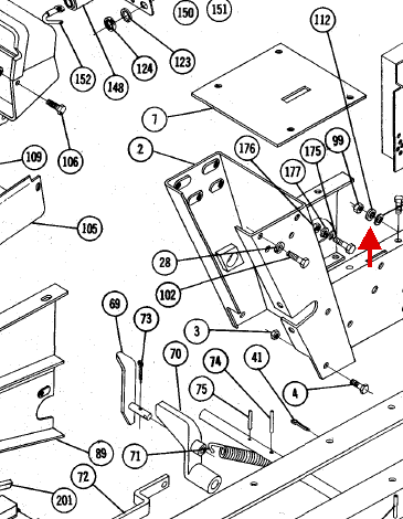

Live4outdoors 151 #1 Posted December 20, 2014 This is the first day I've actually worked this tractor and have found the seat locking lever keeps vibrating back so when I get on and off the seat flips up on me, is there suppose to be a spring to hold it front so this doesn't happen and if so what are the dimensions so I can get one? If not does anyone else have this problem and what do you do....thinking of adding a spring if one isn't suppose to be there. Thanks for the help guys.. Share this post Link to post Share on other sites

rmaynard 16,609 #3 Posted December 20, 2014 There should be a couple of spring washers between the slide and the nylock nuts. Share this post Link to post Share on other sites
520HC 208 #4 Posted December 20, 2014 Yeah, just tighten those two bolts that go thru it and it won't slide back on you. Share this post Link to post Share on other sites
Live4outdoors 151 #5 Posted December 20, 2014 Thanks guys I knew you would all have the answer, just put her away and came in for the evening will tackle that tomorrow before I forget Merry Christmas to you all! Share this post Link to post Share on other sites
