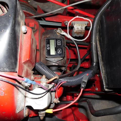

Molon_Labe 731 #3 Posted December 15, 2014 The mag kill relay should look similar to the one circled on this C-111 Share this post Link to post Share on other sites
