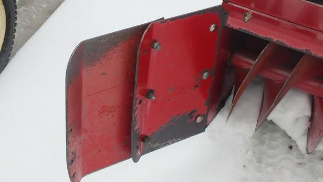

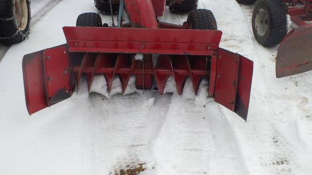

Deer Whisperer 66 #1 Posted December 13, 2014 It helps to save old parts.My snow blower is a 36 inch auger and by adding a extra wing I now cut 46 inches wide. I had the extra parts off a junk blower. With a 1200 foot drive way it has worked great even in deep snow. Its mounted on a 520 H so it has the power behind it. 2 Share this post Link to post Share on other sites

PaulC 342 #4 Posted December 14, 2014 I like that!! I think you could make that even wider if u were to flip the one mounted to the blower around changing the angle? less angle though it might not push it to the auger as well. With that long of a driveway though u might want to try it haha. 1 Share this post Link to post Share on other sites
