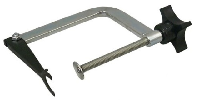

rmaynard 16,552 #6 Posted December 10, 2014 I've never had good luck with that kind of tool. I use one of these on all of my Kohler valve jobs. Cheap ($19.00 on Amazon.com) but effective. Share this post Link to post Share on other sites

Forest Road 594 #8 Posted December 10, 2014 I'm with Bob. The giant C-clamp makes the job a breeze. 1 Share this post Link to post Share on other sites
slammer302 2,156 #9 Posted December 10, 2014 I have one like Bob's it works great on flat head engines 1 Share this post Link to post Share on other sites
