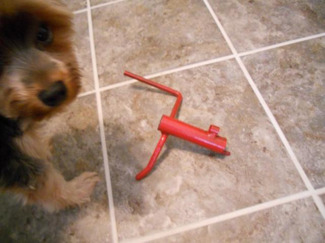

Racinbob 12,485 #12 Posted December 5, 2014 Is this the foot lever? The red piece, not the brown and black fuzzy thing. 2 Share this post Link to post Share on other sites
whtractors24 3,444 #13 Posted December 5, 2014 Yes I just spoke with gentleman said he has everything but belt and pulley on the motor which is awsome.so now I need to know is all of the suburbans with kohler what pulley do they run Size wise ? Or is it 2 pulleys like said above or 1 pulley 2 groves Share this post Link to post Share on other sites
