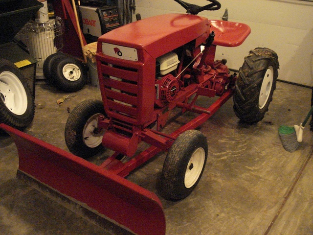

C-85 776 #4 Posted December 5, 2014 My C-85 was suffering from not getting traction in the back, so I made a rear weight box for it. As a result the front end of my tractor was getting light. My little engine (although very powerful) didn't counteract all the weight I had in the back very well, so I made a front weight carrier (bottom photo), put on front wheel weights (which were yellow, but I fixed that), and snow hog tires and it steers pretty good now and has great traction. If I had known about the wrapping the roller chain around the tires idea though, I think I would have gone with that option, instead of buying the snow tires. This what I've done to mine to make it work better, good luck with yours! 5 Share this post Link to post Share on other sites
bean 85 #5 Posted December 6, 2014 (edited) I made the weight on the front of my '73. it weighs 25lbs. while 25lbs wouldn't help your tractor much, you could make something similar in the 50lb+ range. also, you should have plenty of room in front of the 8hp to put some steel or cast iron weights Edited December 6, 2014 by bean 2 Share this post Link to post Share on other sites
KC9KAS 4,744 #6 Posted December 6, 2014 C-85 nice looking front weight frame you made. Did you build it in the kitchen? 1 Share this post Link to post Share on other sites
rollingflat 123 #7 Posted December 7, 2014 Tried to only use rear weights on my horse but didnt work!! 3 Share this post Link to post Share on other sites
C-85 776 #8 Posted December 7, 2014 Hi RedSquare Pro, Are you kidding, I had enough problem just getting this into the house to take the picture, let alone trying to build it in there. But maybe I should push this idea with of building in the kitchen with headquarters ( my wife)? Then I again, I think I'll play it safe and keep the majority of my W/H stuff out in the garage! C-85 2 Share this post Link to post Share on other sites

bean 85 #11 Posted December 7, 2014 Did you build it in the kitchen? it also doubles as a paper towel dispenser Share this post Link to post Share on other sites
squonk 44,701 #12 Posted December 7, 2014 I built a weight similar to Bean's but the plow hits it when raised. Share this post Link to post Share on other sites
bean 85 #13 Posted December 12, 2014 (edited) I built a weight similar to Bean's but the plow hits it when raised. Mike, the plow hits my weight also, but being round, it just rolls on top of the frame. I made the weight to compensate for the weight difference between the kohler k181 cast iron engine and the 29lb Honda engine. and also, to keep the grandson from doing too many wheelies Edited December 12, 2014 by bean Share this post Link to post Share on other sites
