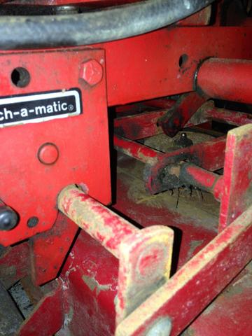

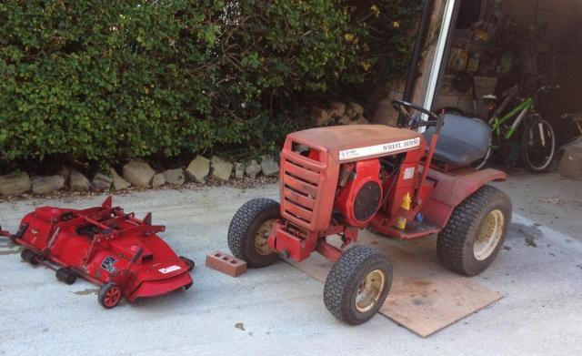

Horse46 519 #5 Posted December 4, 2014 I have taken two pictures of the deck fitted, one is hopefully showing the fitting, and the other shows the rear of the deck just incase there is something I have missed. Share this post Link to post Share on other sites
bmsgaffer 2,069 #6 Posted December 4, 2014 You've got it. It should wobble a little as the deck "floats" under the tractor. If its excessive I would make sure all the bolts on the deck carriage are tight. Also there is a "fork" on the front bar that clips into the attachmatic, make sure that fork is clipped in correctly to the solid attachmatic bar above it. (there should be no rotation of the bar in the attachmatic mount) Share this post Link to post Share on other sites
Geno 1,930 #7 Posted December 4, 2014 That all looks right. What is this twist handle do dah you're talking about? Share this post Link to post Share on other sites

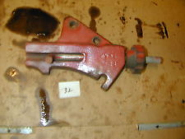

Racinbob 12,800 #12 Posted December 5, 2014 Horse, here's the best picture I could quickly find. If you're talking about the part most of us are thinking this might help. Share this post Link to post Share on other sites
Horse46 519 #13 Posted December 5, 2014 Thats the do dah Racinbob, and I think I got it sussed today too. It fits into the slot in the disc shaped thing at the bottom of the lowering lever, I'm right aren't I, please tell me I'm right? Share this post Link to post Share on other sites

Racinbob 12,800 #15 Posted December 5, 2014 (edited) Well buddy, I'm not sure I can tell you that. The L on the end of the rod doesn't slip into anything. It rides below or you could say in front of the lift arm and limits how far the arm will lower. Things are going to be under the sheet metal on that model. Edited December 5, 2014 by Racinbob Share this post Link to post Share on other sites

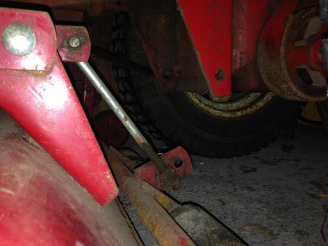

mrocket49 23 #16 Posted December 7, 2014 It's been awhile since I've been inside my tractor but I seem to remember that L rod fitting into a slot at the bottom of the lift rod. The adjustment knob is used to limit the depth of the rototiller or the one-bottom plow/cultivator set. It probably also would be used to limit the height of a center-mounted grader blade. it's not for adjusting the mowing height, though. Share this post Link to post Share on other sites
mrocket49 23 #17 Posted December 7, 2014 I took some pictures of that lift lever and the open slot is where the L- hook attaches. Share this post Link to post Share on other sites
Racinbob 12,800 #18 Posted December 7, 2014 There you go Share this post Link to post Share on other sites

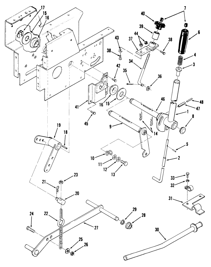

Horse46 519 #21 Posted December 8, 2014 It's piece No.19 the arm not holding piece No.20 also from this drawing I see I also don't have parts 35 and 36 holding 34 in place Share this post Link to post Share on other sites
Racinbob 12,800 #22 Posted December 8, 2014 (edited) 35 and 36 are hardware store items. I'm not sure exactly what you're asking about the arm. if you're talking about the vertical arm on item 19 that is used for the rear attachments as well as where the 'flag' goes for the snowblower. The rear attachment would have a cable running to a rockshaft under the seat. Note that your dial-a-height setup is different than the picture I posted (post #12). The one I showed is for a 77 and older. Edited December 8, 2014 by Racinbob Share this post Link to post Share on other sites
Horse46 519 #23 Posted December 8, 2014 Sorry Racinbob, i was refering to post 16 an 17, this is the model i have, but your picture is the same piece I was originally refering to. however you have answered my question thank you. I forget it not just a mower which is all I use mine for. Share this post Link to post Share on other sites

mrocket49 23 #25 Posted December 8, 2014 And just in case you're wondering, part #9 in the diagram is the replacement shaft you need if you add the electric lift option. Share this post Link to post Share on other sites
