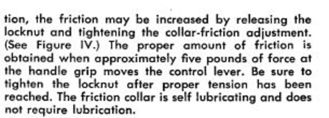

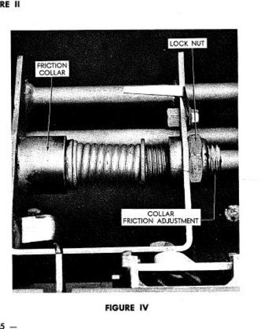

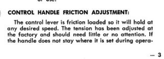

pfrederi 18,648 #4 Posted November 29, 2014 From Electro manual Share this post Link to post Share on other sites

smoreau 658 #10 Posted December 27, 2014 From Electro manual I installed this in my 875! I replaced the plastic slide when restoringit and it woud always jump forward on me. The new slide didn't help and it did it on a trailer for me with me on it. NOT FUN! I had a 69 charger that I parted out to save 3 other tractors and that was left over. After instillation in the 875 (not original) it is SO MUCH SAFER!! It is now a pleasure to drive and the lever now stays were i put it! Had to make some very minor modifications to the tractor tunnel, but well worth the modification! 1 Share this post Link to post Share on other sites
