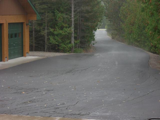

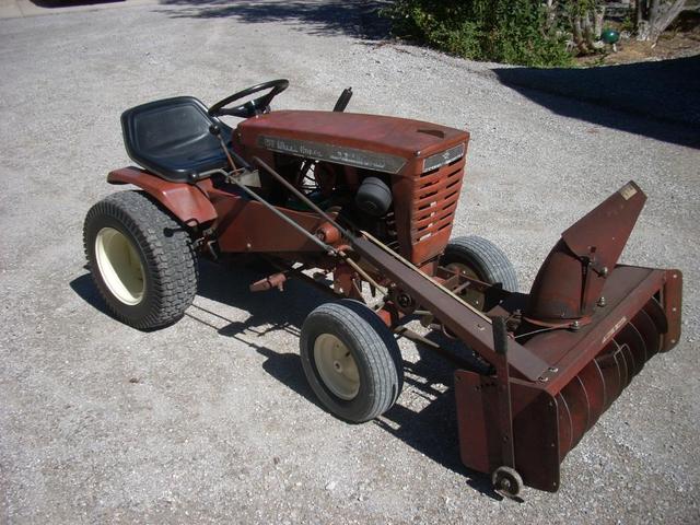

rooney3100 16 #6 Posted November 29, 2014 (edited) It sounds like the rubber chains are the way to go....Thanks everyone for the info.....I will probrably put in my order this weekend.. Here is a pic of my driveway slope and my 66 wheel horse, it worked well, but I need to put on my snowmobile suit and extend the shoot on the blower, it has plenty of power... I also have a 1995 Wheelhorse 416H with around 615 hours that has the 2 stage blower & Cab that I have not used yet, if this liitle guy (1267) works well I will sell the 416H & Attachments, the blower will need a new bearing and a small weld that I will fix, it's parked for the winter in my shed....STEVE M Edited November 29, 2014 by rooney3100 1 Share this post Link to post Share on other sites
wallfish 19,374 #7 Posted November 29, 2014 You got a bunch of driveway there! Get that 2 stage blower going, you won't be disappointed, love mine for that deep stuff. Put a snow/dozer blade on that 1267 and you'll be ready for almost any snow situation. Plow the small stuff because it's much faster and more fun! 1 Share this post Link to post Share on other sites
sorekiwi 761 #8 Posted November 29, 2014 Plow the small stuff because it's much faster and more fun! and you dont get as cold! Share this post Link to post Share on other sites
rooney3100 16 #9 Posted November 29, 2014 (edited) I Have a plow for the 1966, but with the side areas around the sheds (Gravel) I need the blower unit, I like to throw the snow in the woods, we had around 10 inches by Thanksgiving morning and the 66 did good, if it had a taller shoot, that would make it nicer.... Edited November 29, 2014 by rooney3100 Share this post Link to post Share on other sites
