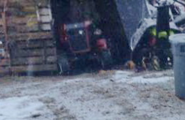

psalms83:18 174 #44 Posted December 12, 2014 (edited) Huh?? What's those tire tracks from?? And what's that!! staring out of the shed in the distance? Edited December 12, 2014 by psalms83:18 2 Share this post Link to post Share on other sites
bmsgaffer 2,069 #45 Posted December 12, 2014 C'mon give us the scoop, what was it? 1 Share this post Link to post Share on other sites
rmaynard 16,780 #46 Posted December 12, 2014 Could it be you got that horse to gallop again? 1 Share this post Link to post Share on other sites
psalms83:18 174 #47 Posted December 12, 2014 We'll guys I gotta say, I might be difficult to deal with sometimes, but I appreciate all your advise and help! I went out today after doing my research on selling the WH piece by piece, and I had about had it! So again I prayed ; is this red beast going to be a blessing or a curse!! I heated up the oil checked the lines again heated it up some more, checked the wheel key holes, checked oil levels, heated it up some more, and all the time remembering a line from a manual I think I can find it...... Ok can't find it right now but someone or a manual stated... Reinstall pump, run the engine then "shut off" ...THEN transmission is ready. Made me think after it had settled overnight it might be ready. Sure enough when I got her running I grabbed the hydraulic lever and it moved!! I felt the control arm on the hydro and for the first time felt like there was something there!! It did move about a foot then lost it! But after letting it sit Again, actuating the hydraulics and the hydro, turning it back on, it moved a couple feet!! So back and forth on off actuating on off (low rpm by the way cause someone mentioned it was better to get it primed low rpm than full out) off and actuating on and actuating. After about the fifth cycle I could get it to move forward what seemed with out it bugging out on me. Then I tried reverse, and it crapped out. So another 4-5 cycles later reverse works a little. Things are a little finicky buggy but I'm sure ...it "might" smooth out! So here comes another oil change and filter also. Thanks so much for everyone's opinions and advise!! Thank everyone for all your help. In the spring I'm gonna try reinstalling the old hydro and cycling it...to see if it works or not. Coarse then I'm gonna strip the whole thing down and give it a new custom look!! My bro has a motorcycle fabricating shop, makes Jesse James look like a kid with a cub cadet!! 1 Share this post Link to post Share on other sites
