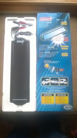

shallowwatersailor 3,216 #1 Posted November 22, 2014 (edited) This winter, the two tractors with plows are going to be outside due to space. Not a problem as it won't snow here . I found this on sale for half price this week ($20.00) at Northern Tool. They use the same plug as the Battery Tender wire that the tractors already have, Each panel generates 1.5 watts @ 12V so each panel should be sufficient to keep the batteries at their peak. I also plan on exercising the tractors every few weeks as well. Edited November 22, 2014 by shallowwatersailor 1 Share this post Link to post Share on other sites

Sparky-(Admin) 23,988 #6 Posted November 22, 2014 The only thing I don't see is how the charge is regulated. I have a charger/ maintainer on my Corvette and one on my Honda Rancher and they both have built in regulators to prevent overcharging. Do these solar panels have that? If not I wonder if you could "cook" the battery by overcharging. Mike............ Share this post Link to post Share on other sites
JustinW.73 224 #7 Posted November 22, 2014 The only thing I don't see is how the charge is regulated. I have a charger/ maintainer on my Corvette and one on my Honda Rancher and they both have built in regulators to prevent overcharging. Do these solar panels have that? If not I wonder if you could "cook" the battery by overcharging. Mike............ I think it just has really weak cells so the max output is 1.5 amp Share this post Link to post Share on other sites
bmsgaffer 2,065 #8 Posted November 23, 2014 I think it just has really weak cells so the max output is 1.5 amp They are 1.5 WATTS. At 12V that is 125mA (milliamps). I think it would be very hard to hurt a battery at that current anyway but these are just maintainers. A normal charger charges a battery at 16 volts or more, thats how you can overcharge it. A maintainer may output 13.8 volts at most so as the battery gets full the voltage of the battery matches the voltage of the solar panel and no current flows. This is only in theory as the batteries are always discharging even just a slight amount so some small amount of current is flowing. Share this post Link to post Share on other sites
