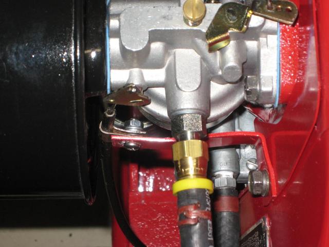

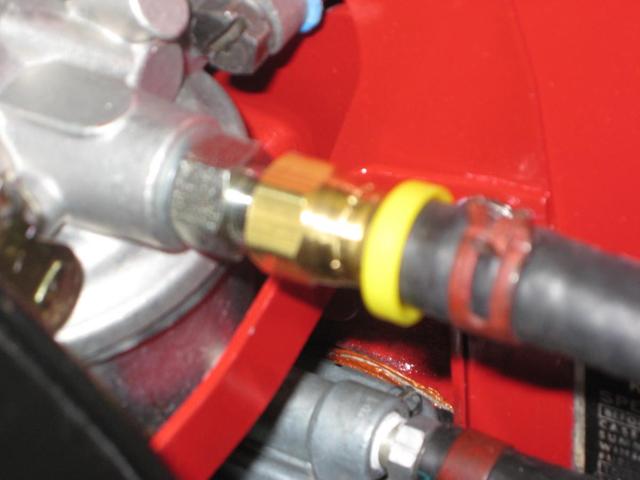

I don't know if this info is out there, I didn't do a search. On the Chinese carbs that replace the Kolher K181 the fitting that the gas line goes to is not a pipe thread nor is it metric. It is known as British and it screws into the carb and seals with an o-ring and washer then a second fitting with a barbed shank screws into that fitting and is sealed by compression. Do not try to force a pipe thread fitting you will only damage the carb. I installed one today simple and leak free.

I got these fittings at Rivercity air & hydraulics here in Austin,tx but I'm sure any company that makes up hydraulics hoses will have these fittings.
