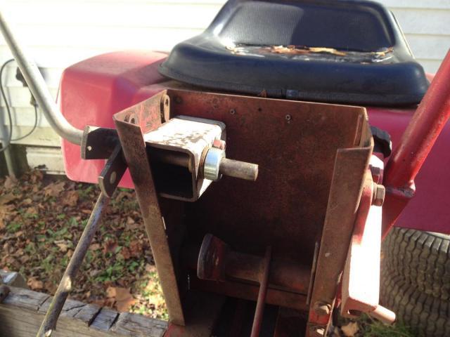

autoxman 3 #10 Posted November 28, 2014 (edited) You can use a manual PTO, preferably an older one from the 60's that uses the long engagement bar like the set-up pictured. Edited November 28, 2014 by autoxman 1 Share this post Link to post Share on other sites
Ed Kennell 43,157 #11 Posted November 28, 2014 You can use a manual PTO, preferably an older one from the 60's that uses the long engagement bar like the set-up pictured. I like this Auto. I think the 8HP Kohler has a 1" dia PTO. Do you know what other engines have the 1" dia ? Share this post Link to post Share on other sites
Racinbob 12,248 #12 Posted November 28, 2014 That setup is a good idea Ed. It would be an easy adaptation. If you find one for the larger shaft motors you'll just need the bearing race to fit it to your 8hp. Share this post Link to post Share on other sites

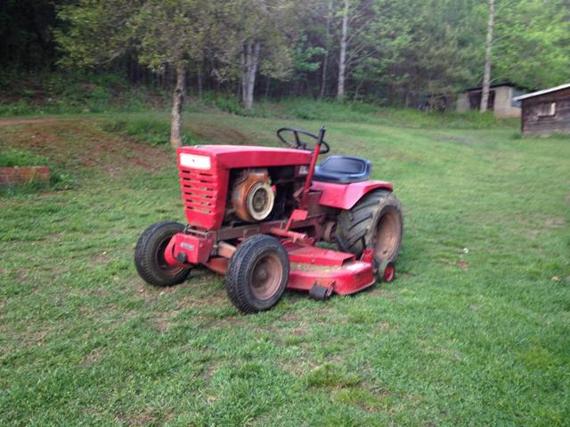

Bert 760 #13 Posted November 28, 2014 I built this setup and used it for years, it worked great. I have a small pulley like pictured above but went with the typical larger one, 1st gear was still low enough to mow or push snow/dirt but 3rd would fly. I think you'd be better of with the small pulley so the belt guard would fit. I also used a C100 frame and raider hood and fenders, but that was for the new mule drive and old look. I think a raider or charger mule drive and deck would work on a short frame. With the newer decks the outside rollers will hit the front tires so keep that in mind. Oh yeah that hood stand is from a 855. Hope this helps some Share this post Link to post Share on other sites
