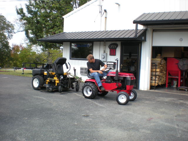

47JDG 65 #8 Posted November 21, 2014 (edited) I am sure it will be no trouble at all. 120kgs = about 265 pounds and the standard hitch should have no problem with that. I have seen people put a lot more on them with no trouble. As far as pulling the weight around you shouldn't have any trouble either as long as you are on level ground or close to it. A friend of mine uses a 1077 WH every day to pull and push dead vehicles into his repair shop to be fixed. He has a couple tires fixed to the front of the reinforced hood so it don't scratch or damage the vehicle he is pushing. It's an incline up into his shop, but the WH has no issues. It's pretty impressive what they will do. Just remember to be careful and remember what your moving weighs a lot more than the WH does. Edited November 21, 2014 by 47JDG Share this post Link to post Share on other sites
