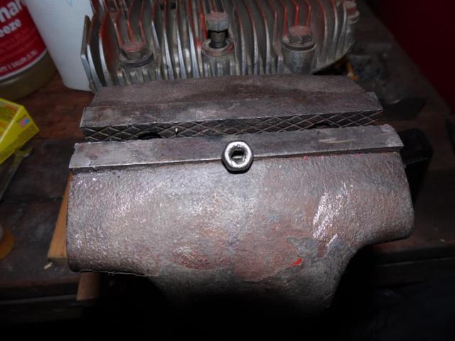

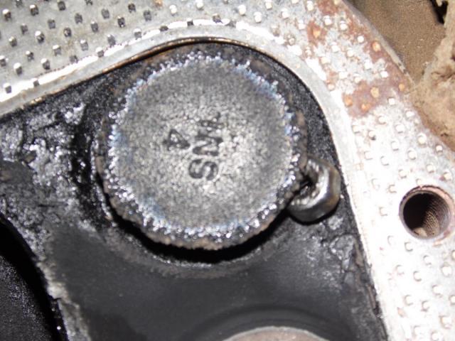

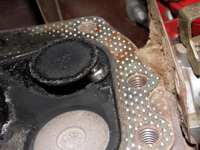

Molon_Labe 731 #1 Posted November 17, 2014 4" of snow this morning and it was time to clear the driveway. 2 passes and then POW! Dead as a door nail right in the middle of the road at 6:00! Got the wife up and she steered while I drove the C-101 pulling the C-161 Auto to the garage. Pulled the spark plug and no compression, at this point I thought it had a broken rod. Pulled the head and here is what I found! I bought the tractor last year and have had no problems with it what so ever and where that nut came from I have no idea but it's been in there for a long time as you can see from the next pic. No dings or dents in the piston tells me it's been rattling around under the intake valve for a very long time. Cleaned the carbon, new head gasket and back to plowing snow by 9AM. 3 Share this post Link to post Share on other sites

RMCIII 839 #4 Posted November 17, 2014 (edited) That is crazy. It had to of been inside the exhaust valve port. There is no way that nut could have survived that long any other place. Not enough clearance top side. Sure would not have worked it's way up from the crank. Seen some good one's before, but wow, that one really takes the cake. Rob Edited November 17, 2014 by RMCIII 1 Share this post Link to post Share on other sites

squonk 45,345 #6 Posted November 17, 2014 I'm guessing it was a nut to hold the air cleaner cover on at some point. 2 Share this post Link to post Share on other sites

Molon_Labe 731 #16 Posted November 19, 2014 It's just luck that the valve caught it, otherwise it would surely have ruined the engine. Share this post Link to post Share on other sites
