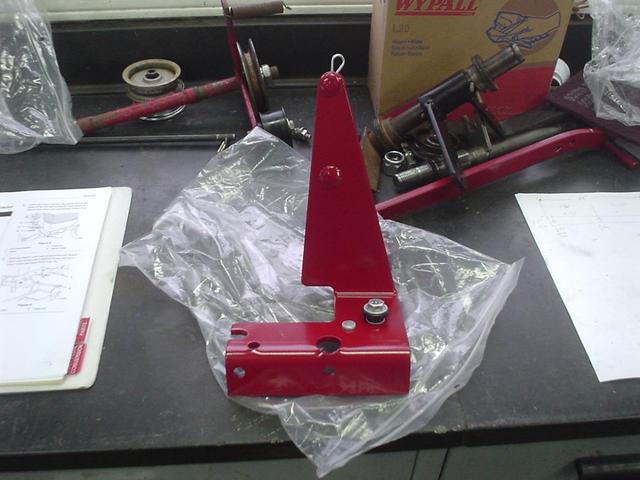

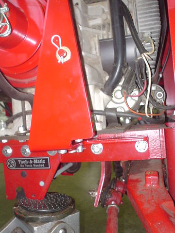

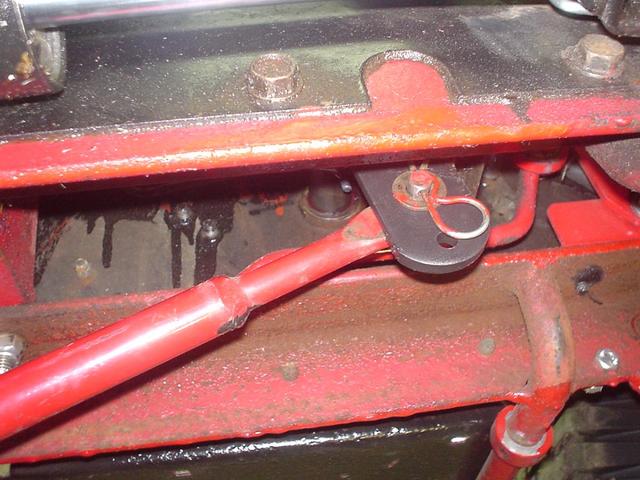

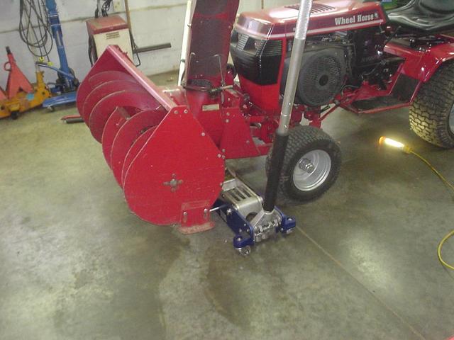

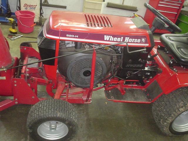

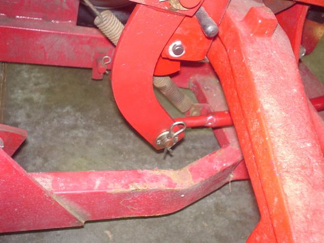

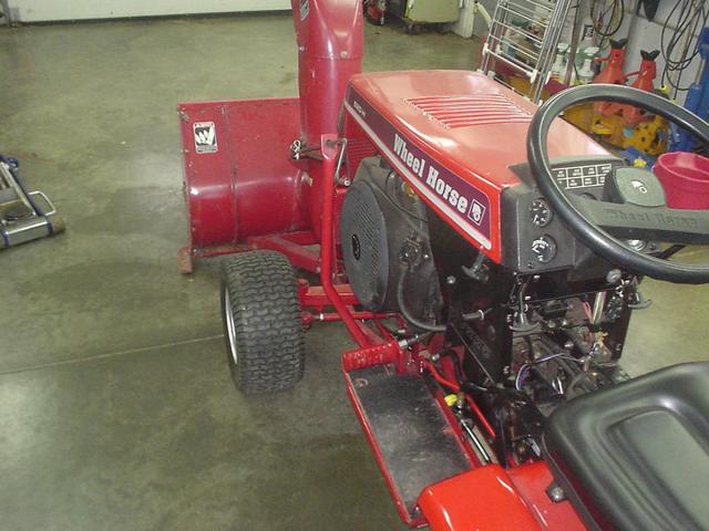

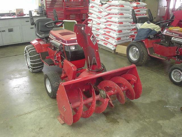

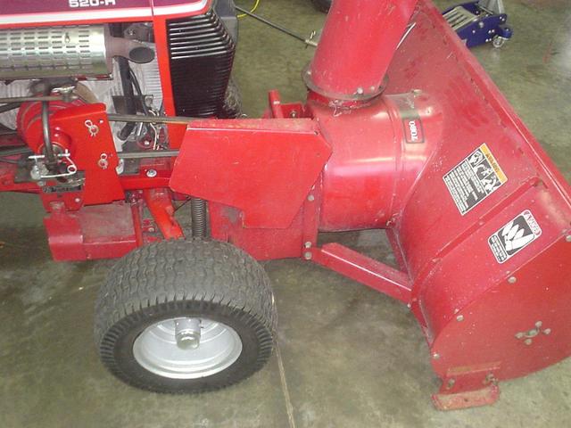

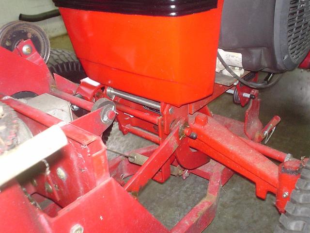

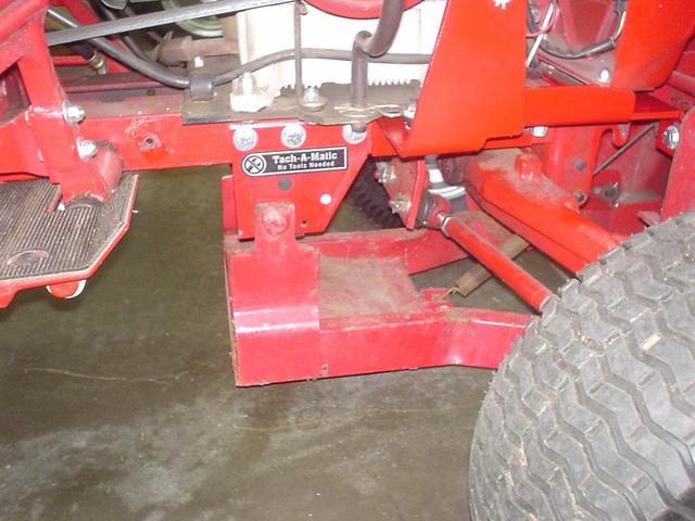

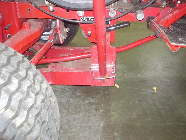

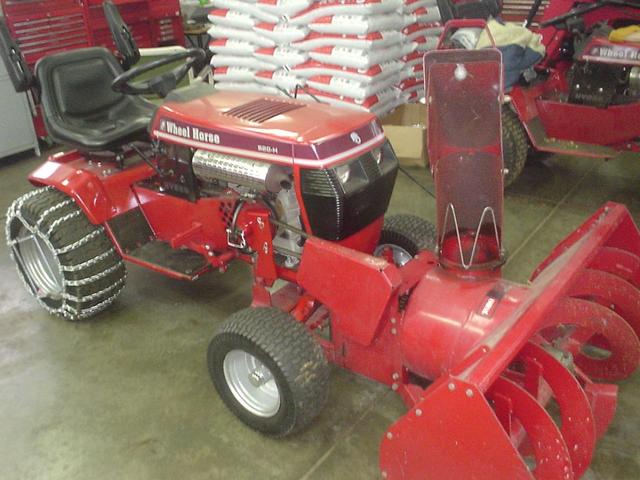

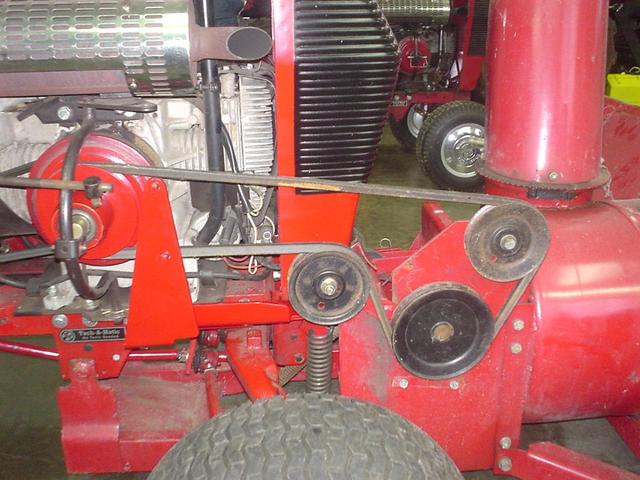

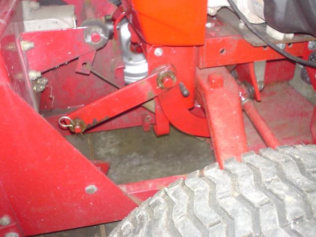

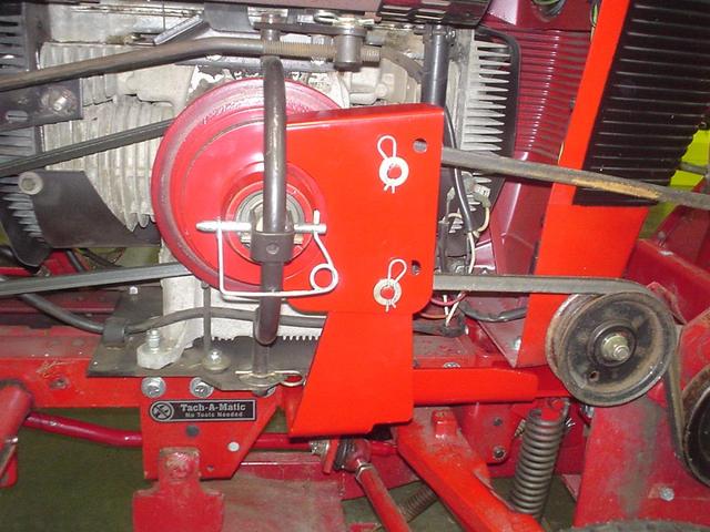

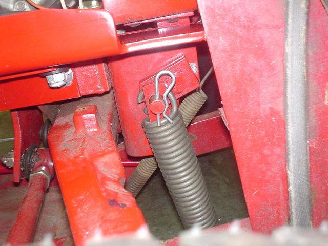

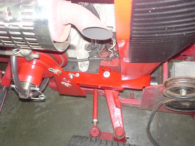

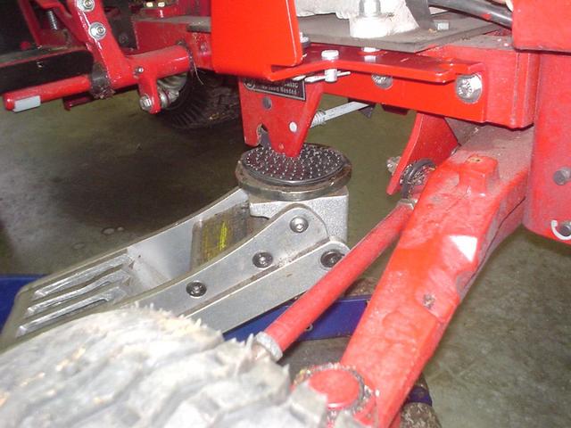

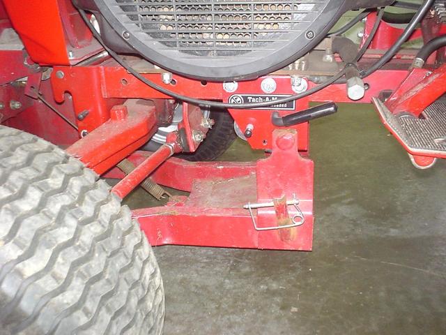

cleat 8,747 #6 Posted November 16, 2014 (edited) I followed the installation steps in the owners manual except for the following modifications. Step 3 I used 1-1/4" bolts with a flat washer under the head of the bolt and under the nylock nut. Jack up front end of tractor to give more room to install front nut. Ensure bracket is as low as possible in the bolt holes when tightening. Step 10 lift assist spring not used with hydraulic lift. (Lift spring at front of tractor behind blower is used however). Step 12 use whatever hole works best for you. Step 13 I used a jack to raise blower instead of the procedure outlined in this step. Step 17 N/A in my case Step 24 I used the inner holes even with my 2 cyl engine. Note: Be sure to adjust antisway bar round block up against blower to reduce the blowers tendancy to sway in use. Lube chain and check tension Air up front tires to 20 PSI Lubricate chute Check gearbox oil levels Check auger shearbolts (5/16 x 3") Cleat Edited November 16, 2014 by cleat Share this post Link to post Share on other sites
gabe911 23 #9 Posted November 17, 2014 Cleat, that is one clean horse you have there! Also the snow blower is Boss! You have me on the prowl for a 2 stage now! P.s. thanks for all the pics Share this post Link to post Share on other sites

Forest Road 595 #11 Posted November 19, 2014 I've had a 2 stage for a few years now. It's mounted on a hydro lift tractor. Haven't used the spring once. I'm not sure but I doubt many guys here use it. Just seems like a lot of aggravation to get it on. And I believe it's intended to assist the MANUAL LIFT tractors. Happy Snow Blowing! Share this post Link to post Share on other sites
cleat 8,747 #12 Posted November 20, 2014 Front lift spring is really easy to install, just lift the lever, install the spring, and push the lever back down. With the spring on I can lift the blower from the front manually with one hand easily. This allows the blower to float on top of my gravel drive instead of digging in. Cleat Share this post Link to post Share on other sites

j4duncanr 1 #14 Posted November 20, 2014 when I got the blower it was a ebay purchase.so it was somewhat completey put together.well they put the lift assist spring on where the big lift spring shoulda been and when I raised it up the right side was higher than the left.i kept lookin at cleats pics and realized the issues.i changed them today and now it raising almost even.but I still don't think its high enough.i have the left pin in the bottomleft hole.now. Share this post Link to post Share on other sites
