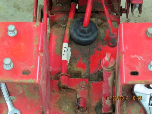

Molaker 15 #1 Posted November 6, 2014 There is a small tube running from up around the front of the shifter back to the top of the rear end. Nothing was running through it when I tore the thing apart. I can't tell for sure what is supposed to run through it...fuel line?...seat switch wires?...what? I've marked the tube with a piece of tape in the photo. 1 Share this post Link to post Share on other sites
Molon_Labe 731 #2 Posted November 6, 2014 That tube is for the slot hitch cable that connects to the lift handle. 1 Share this post Link to post Share on other sites
chipwitch 73 #3 Posted November 6, 2014 (edited) That's the guide for the cable that goes back to the rock shaft (which is missing in the picture). Which then goes to the tiller or other attachment Looks like I was a bit slow... Edited November 6, 2014 by chipwitch Share this post Link to post Share on other sites

Molaker 15 #5 Posted November 6, 2014 Thanks, all. After I posted this, I about had decided it was for a cable by the way the ends were flared. Looks like the front is position for a cable to be routed down to the lift mechanism. Anyway, I don't have any attachments and don't plan on getting any with the possible exception of a front blade...maybe someday. Share this post Link to post Share on other sites
